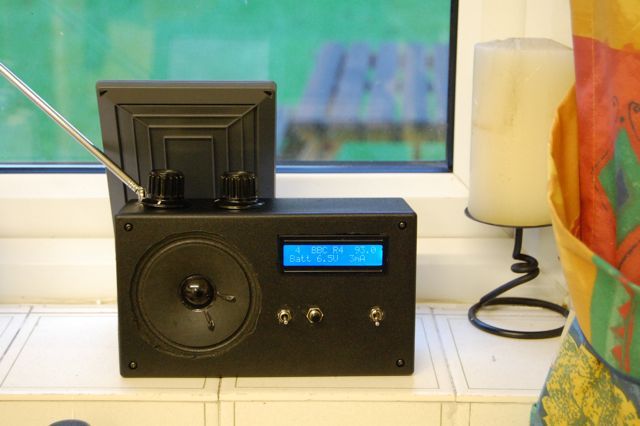

If you want to be able to control the tuning of your radio (you don't have to, you can just set the frequency in the sketch) then optionally use a solderless breadboard to hold a pot (I used 10K linear).
The pot should be connected with the center slider to Arduino pin A0 and one end to GND and the other to +5V. Turning this pot will change the frequency.
Step 5: Conclusion
Note that I actually used a Freetronics USB Droid board, as that was what I had to hand, rather than an Uno, but an Uno will work fine.
On the right-hand side of the breakout board (top in the picture above) I attached a 3.5mm socket to one channel and GND and poked a length of wire into the ANT socket to act as an antenna.
The sketch is very simple, all the real action is in the function setFrequency().
In the 'loop' the analog reading from the pot is converted into the frequency range and then rounded to 1 decimal place, to make it easier to tune.
The output from the module requires amplification. An iPod dock with aux-in will work fine and I was surprised at the quality of the sound, given the price.
