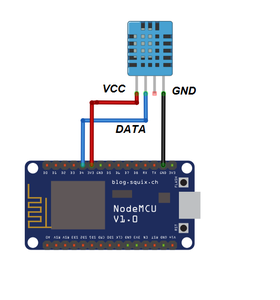

  • Connect DHT11 temperature and humidity sensor to the D4 pin of NodeMCU.

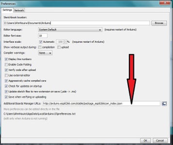

1. For ESP8266 library, start Arduino and open the Preferences window.Enter :
http://arduino.esp8266.com/versions/2.4.2/package_...
in additional boards manager URLs filed.

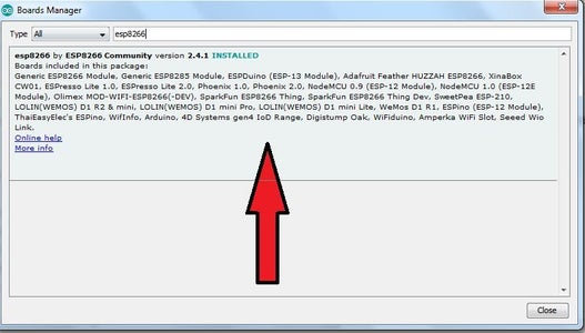

Open the Boards Manager from the Tools > Board menu and find the ESP8266 platform. Select the version you need, then click the install button. select the ESP8266 board from Tools > Board menu.
