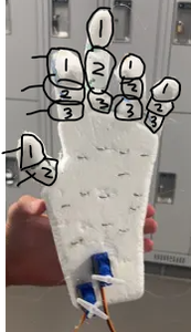

Step 2: Robot Hand
  • I first traced my finger for the model of the hand
  • then I would cut the Styrofoam into rectangular prism pieces with the exato knife in measurements of my fingers
  • Then we shaved the fingers and took the measurements of the cylinder with the hemisphere
  • Then I cut the fingers into 3 separate sections that are called a truncated cylinder and 2 for the thumb
  • then I put a fishing line through each section of the fingers to connect them together so then later it can be moved with the servos.
  • then I cut paper in half so the clips could hold the fishing line on the hand
  • then I used Elastics to hold the fingers in place by cutting them into small pieces and putting each piece on each knuckle

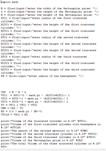

Step 3: Math Coding
For the math part I had to make a code in the image i provided iy shows that the code is mostly defining each variable for example W = float(input("enter the width of the Rectangular prism: ")) this is defining that W will be the width of the rectangular prism and this is the same for the rest of the defining part of the code just different variables then we use the variables to make a code to calculate the volumes of shapes for example VRP = W * H * L this is showing that Volume of rectangular prism is Width x height x length Then the last part is printing all the answers to make it easily readable the printing part would look like print("Volume of the Rectangular prism is %.2f" %VRP) this will show the answer for VRP = W * H * L and then this is just a rinse and repeat for all the other variable and print codes.

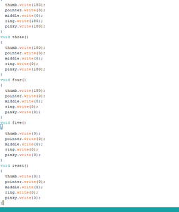

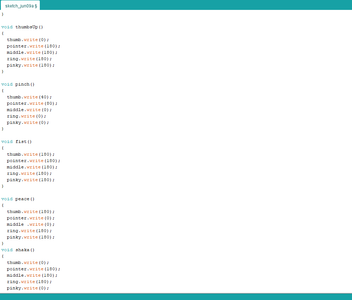

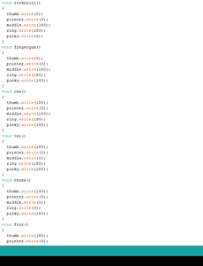

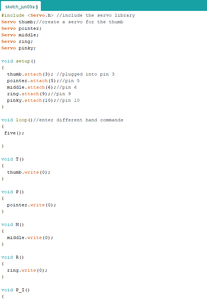

Step 4: Tech Coding
For the project we had to create a code meant to move each finger separately. The first part of the code was to include the servo library as this will allows the servos to be controlled by the Arduino . Then the next step was to have a void setup in the code to send code and power to the pins that control the servos. Then we have create different gestures with the hand with code. An example of an gesture would be the thumbs up, in the code we would make all the servos do a 180 degree angle except the thumb because if you make it 180 it will bring the fingers down and if its 0 it stays up so so making them all on 180 and the thumb 0 will make a thumbs up gesture.
Step 5: Adding Motors
Then the last step was adding the Arduino and servos to the hand. I first started with the servos by gluing them on the hand and wrapping the string around it so when the servos spins it will move the fingers. I then added the servos wires on to the Arduino to give it power and code from step 4 to move the motors which then would move the fingers down and up.
