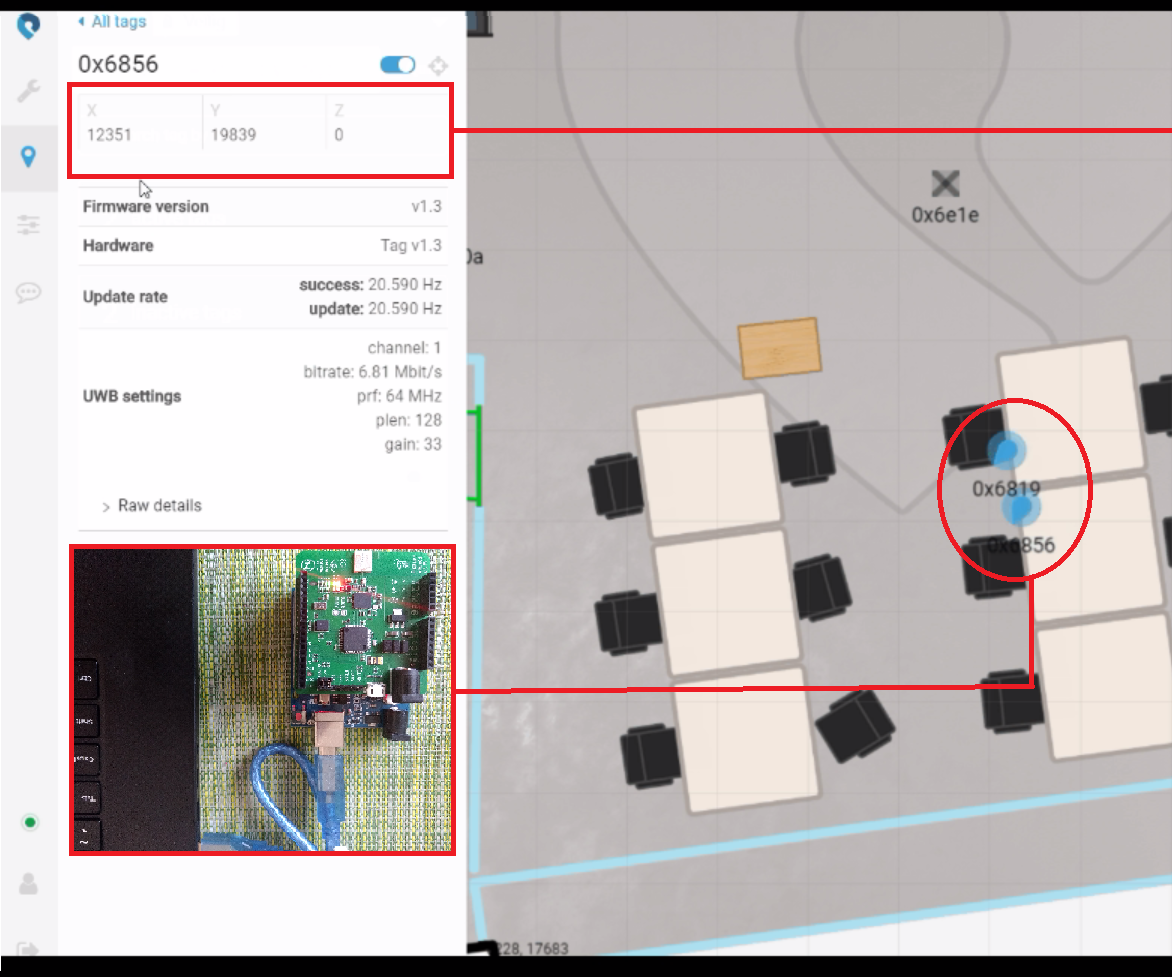

I ran the code on both a wemos D1 and an arduino uno. I set the time equal with the time from:http://www.timeanddate.com/ on midnight day zero (you obviously dont have to start at midnight! - I included time set code above void setup). After one day and 9 hours the difference between the time on my microcontrollers and this website was about one second. I checked this by taking a screenshot of my serial monitor on one side of the screen and having the webpage open on the other side. (see pic).
After about 3 days, on both my arduino and wemos the clock was about 2 to 2,5 sec fast. that is 274 seconds a year off or just over four and a half minutes. That's unacceptable!!! No, not really. I just added a line of code to my sketch that corrects the time on my microcontrollers either by delaying the program just a little every 24 hours or by adding a few milliseconds every day. In my case about 0,75 seconds every day. And there you have it, long term near second precise timekeeping with no fuss on any board!
