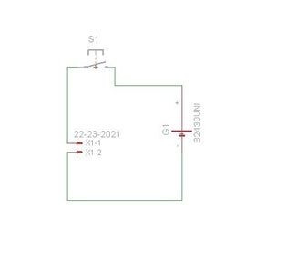

Step 1: Testing LED
Here is the circuit diagram for testing LED. When you press the switch, the circuit gets connected and the LED glows if it is working.
We are making with the help of only one battery, so connect all the systems that are coming ahead with one battery!
Can also be used to test IR led.

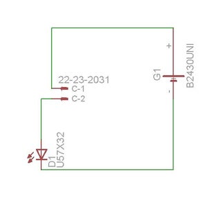

Step 2: Testing Transistor
Follow circuit diagram for testing transistor. Here using this circuit you can check whether the transistor is PNP or NPN. If the Collector and Base of transistor is short, then it is NPN otherwise the transistor under test is PNP.
LED is there to show indication whether it is NPN or PNP.

To Check LED:
Just Plug LED into the LED Section and Press the Button. You will see LED Glowing and if not LED is not Working. Easy Enough!! Moreover you can also test IR LED but for that you need a Camera.
Remember to Check Polarity!
To Check Transistor:
To Check if Transistor is NPN or PNP. Plug the Transistor in Order Of CBE and if LED Glows, Transistor is NPN or else PNP Transistor.
