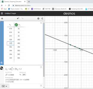

Step 3: Regression Analysis With Desmos
Regression Analysis is a mathematical process that attempts to derive a function from a set of (x,y) points.
There are various types of regression analysis available in Desmos, namely:
Linear y = mx+b
Exponential y = ab^x+c
Logarithmic y = alogx .....
Quadratic y = ax^2 + bx + c

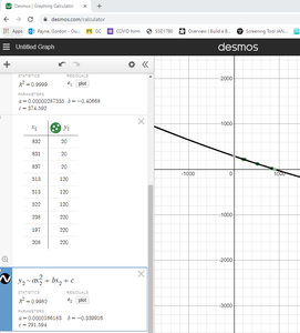

In my testing, I found that Quadratic regression gave the best results. We'll do one regression analysis for the x-coordinates and a separate regression analysis for the y-coordinates. You'll have two equations you can use to convert touch points to screen coordinates very accurately.
Please watch the attached video to see how to analyze the sampled points to get the coefficients for mapping touch-x values to display-x values and touch-y values to display-y values.
Screen shots of a similar regression analysis process are attached as well.

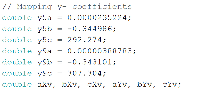

Step 4: Include Coefficients in Your Sketch
Insert the a,b and c values from your regression analysis into the sketch.
Look at the map2d() method.. It accepts touch point x and y coordinates and maps them to display (x,y) cooridnates.
Compile and upload the sketch to your Arduino and try it.
You should now see a better coordination between the point touched on the screen and the display response.
The big advantages of this method are that your touch coordinates map to your display coordinates and now you just use the display coordinates for your sketch instead of having to incorporate touch and display coordinates into your sketch touch detection logic..
