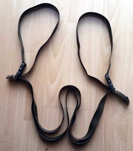

Step 7: Making the Straps
I got thoes buckle straps cheap from an army shop, but you can use other too.
Take one buckle strap and twist the end of the second through the slot of the bucket like in the picture above.
The strep is perfect to transport the laths in one pack.
