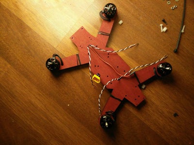

Step 7: Mount the Motors
A complete no-brainer? Nope you need to refrain from over tightening and also refrain from using long screws which may end up poking into the motor windings and ultimately shorting it.
Use M3 hex/allen nuts for securing the motors. The one it comes with is too small.
I am using DYS SE2205 2300kv Motors they are excellent! (Not for beginners)

Step 9: Soldering the ESCs to the Motors
Cut the ESC and the motor wires to about the right size to actually fit neatly like in the picture. Don't forget to add your Heat shrinks before soldering. And also don't worry about the motor direction we will change that later in BlHeli Suite.
Optionally you could also remove the heatshrink from the speed controller and remove the existing wire and replace it with the motor wires but the problem with this method is that there is a risk of killing your esc due to over heating.
Soldering tip: Always Twist the wire strands after removing the insulation and then tin the wire with solder doing this will not let the wire fray. While soldering remember to always heat the wire with your soldering iron and then feed the solder to the wire. This way you will always have a shiny clean solder joint which will not fatigue.
Always remember to retin wires with your own solder because the solder they used will be different.
(I prefer 60/40 lead soldering wire)
Now solder the esc power wires to two of the pads on the PDB with correct length. Don't bend the wires cut them they will save weight, as every gram counts.

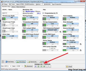

Step 23: Setting Up Your ESCs Through Blheli Passthrough (Reversing ESCs, Enabling Damped Light Etc).
The Latest Firmware of CleanFlight has a feature called serial one wire pass-through which lets the operator rogram each ESCs individually as well as all simultaneously through the USB connected to the naze32 board.
For this setup you need to download the lastest firmware of BLHeliSuite from here. Once downloaded Plug in your USB cable and connect your battery ( I recommend using a 2s battery to avoid frying your motors when testing the motor direction). Remember to Disconnect from CleanFlight if you have connected it to it. And remember to choose the right COM port. If you get a message saying upgrade available, then upgrade them.
To check your motor directions click on the motors tab and check the check box (always remove your propellers while doing this). Slowly move the slider for each motor one at a time and note the motor direction on a piece of paper. Use the image to know which motor direction is right and which is wrong. Change the direction if necessary.
Follow the notes on the pictures and you should be good to go!
Here are my settings for all ESCs:
- Damped light
- Beacon Strength 0
- Enable PWM input : OFF
- Beacon Delay to infinite.
- PWM minimum/center/Maximum to the default settings set by the calibration done on CleanFlight previously (you may get the message that it's not in sync to master but you can ignore that).
- Motor timing set to medium-high
https://oscarliang.com/flash-esc-via-cleanflight-f... has a very good How-to on this step and Joshua Bardwell has an amazing video which explains each setting in BLHeliSuite one by one, be sure to check out his YouTube channel for more great videos.
