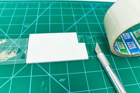

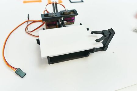

Step 2: Prepare Board
The board part should be printed in white and then covered with clear packing tape as shown in the the photo below (the tape will make it very easy to erase the board between games)

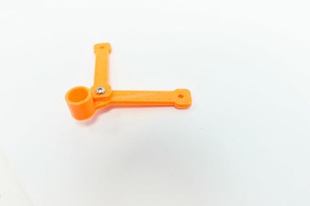

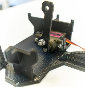

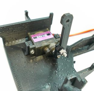

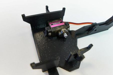

Step 3: LIFT Servo

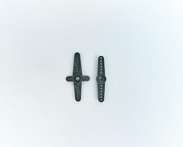

Take one of the plastic servo arms (included in the servo bag) and drill a 3mm hole in the center of it.
Use a cutter to make the arm shorter.
Attach the two parts using a 12mm screw and nut as shown in the photos below (orientation is important!)
Do not tighten the screw. The parts should be able to rotate against each other freely.
Attach the LIFT servo to the base using two screws included in the servo bag.
Important: Connect the servo to an Arduino and rotate it to 80 degrees. Only after doing this, attach the arm to the servo, like shown in the photos.
The angle between the servo and the arm should be 90 degrees as shown in the photos (this is important).

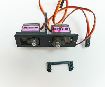

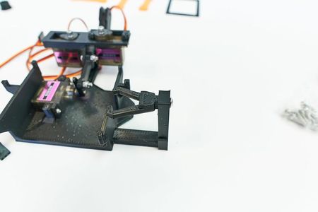

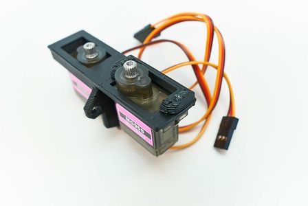

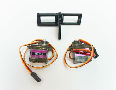

Step 4: LEFT/RIGHT Servos
Attach the servos to the holder as shown in the photos below (orientation is important!).
Attach the RIGHT/LEFT servos holder to the LIFT servo arm with a 12mm screw and nut.
The RIGHT/LEFT servos holder should also be attached to the base using a 14mm screw and nut.
Step 5: Eraser Holder
Use 2 X 12mm screws to assemble the eraser gripper.
At this stage, you can also install the board in its place.

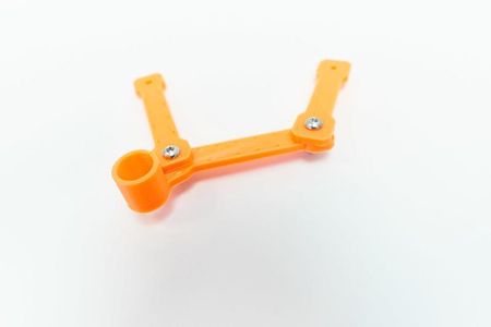

Step 6: Arms Assembly
Assemble the arms precisely, as shown in the photos. Use 12mm screws and nuts.
Do not put the arms on the servos (we will do it soon).
Inside the servo bag are two additional plastic arms that we haven’t used yet.
Use a cutter to make them “one-sided,” as shown in the photos.

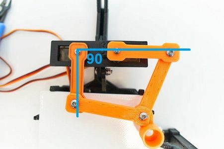

Important: Connect the servos to an Arduino and rotate them to 130 degrees (left servo) and 140 degrees (right servo). Only after doing this, attach the arms to the servos like shown in the photos below (do not rotate the servos while doing so).
The angle between the left arm and the right arm should be exactly 90 degrees, as shown in the photos.
