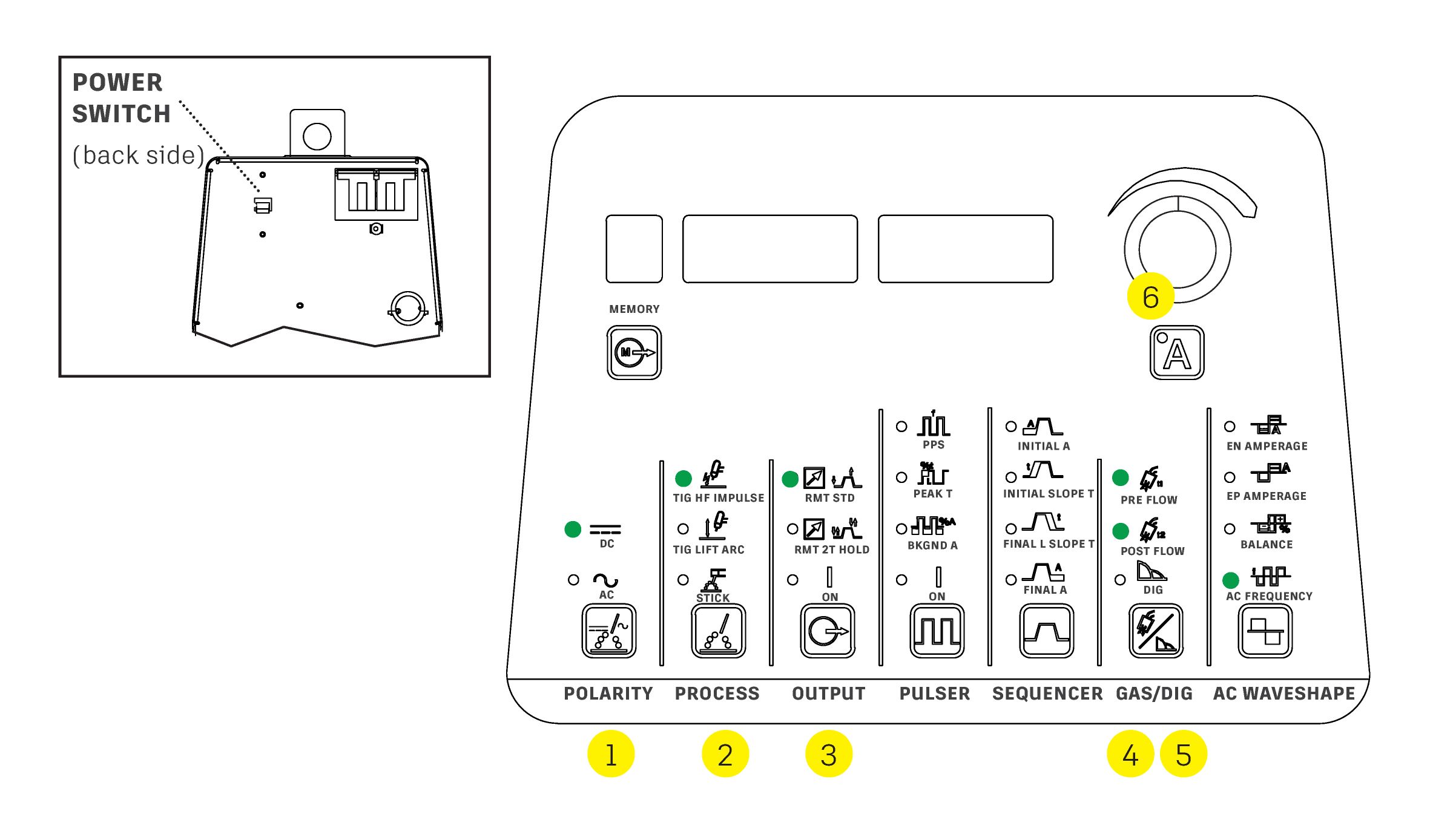

Step 1: Settings for Welding Steel
- Turn the machine on with the switch on the rear panel.
- To change the settings:
- Push the buttons on the bottom row.
- A green LED will indicate the selected option.
- Some options require turning the amperage knob, and reading the result in the display.
- Set polarity to DC.
- Set process control to TIG HF Impulse.
- Set output to RMT STD to enable the foot pedal.
- Set the GAS/DIG to Pre Flow
- Rotate the amperage knob to select .02 seconds.
- Set the GAS/DIG to Post Flow
- Rotate the amperage knob to select Auto.
- Press the “A” button and turn the amperage knob to set the maximum amperage you plan to use.
- The foot pedal is used to control the amperage between 0 and the maximum you selected.
- Try starting with one amp for every .001” of material thickness.
- ex. For 1/8" (0.125") material, start with 125 amps.

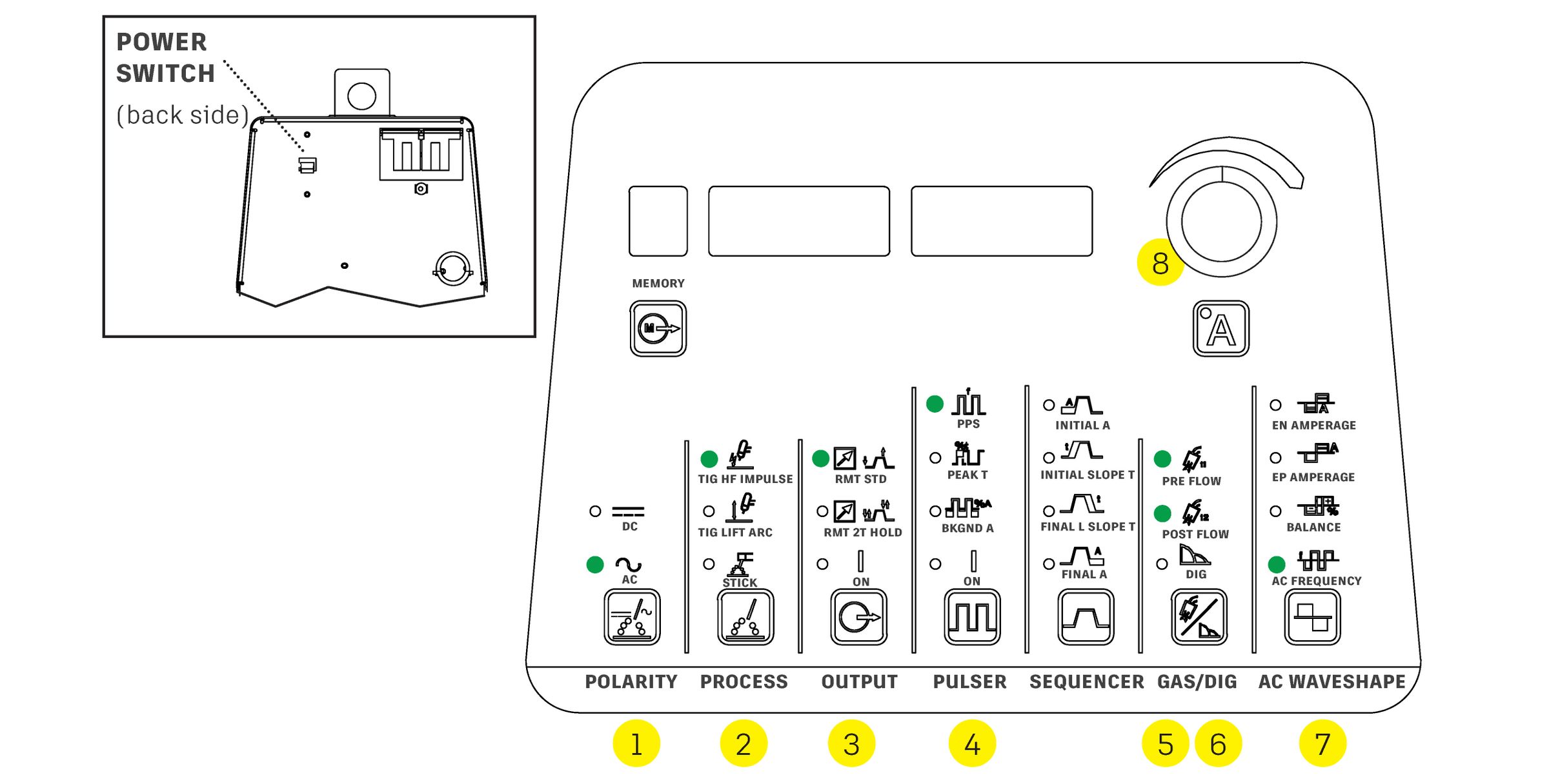

Step 2: Settings for Welding Aluminum
- Use pure tungsten, with a green band on the end, or thoriated tungsten, with a red or yellow band.
- Push the button on the bottom row.
- Set the polarity to AC.
- Set the process to TIG HF Impulse.
- Set the pulser to PPS
- Rotate the amperage knob to set the number of pulses to 4.
- Rotate the amperage knob to select .2 seconds.
- Set the AC waveshape to AC Frequency.
- Press the “A” button and turn the amperage knob to set the maximum amperage for the session.
- The foot pedal is used to control the amperage between 0 and the maximum you set.
- Start by setting one amp for every .001” of material thickness.
