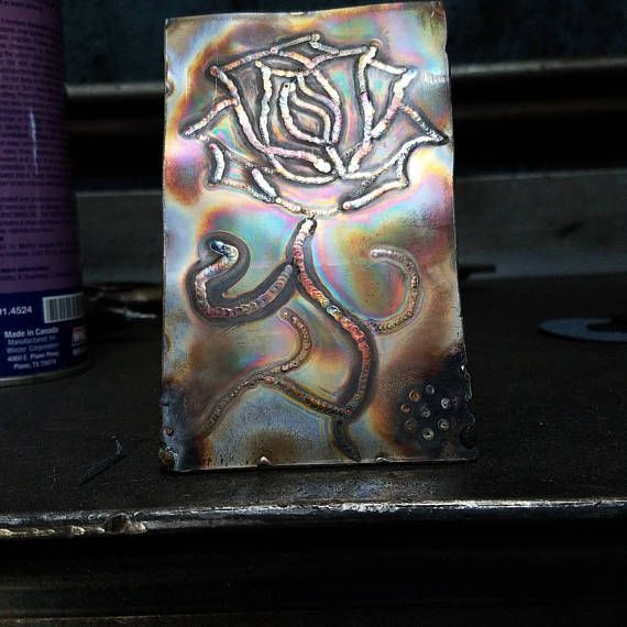

lets discuss argon shielding a little bit, to obtain to colors your looking for in the stainless, theres 2 things you need to control, heat input and shielding gas. argon coverage can make or break one of these drawings, not enough and it comes out looking super dull and crappy, too much and you'll have a nice shiny silver outline but no color. i typically run 18-20 CFH with a #8 ceramic cup on a stubby gas lens, if you have a larger cup you may be able to adjust flow a bit better and try some other stuff out, but i like my #8 cup just fine.

once the piece is welded down securely its time to begin welding your design, i typically like to start at the smallest detailed spots and work my way around stopping occasionally to prevent my torch and the stainless from overheating. take quite a few 10 minute breaks during the process of this in order to keep the color concentrated on your drawing.
now that you've completed your drawing you will need to cut the piece off of the backing material and grind the edges to a smooth finish. be very careful during this process, one slip and you could leave a huge gouge in your drawing.
