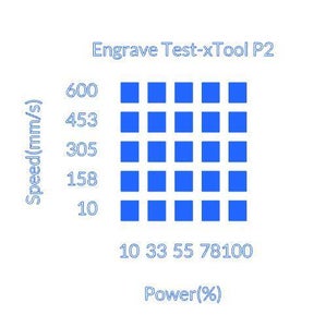

Test Grid

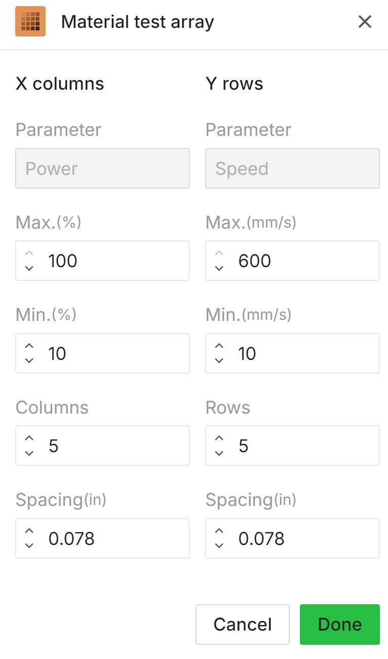

The test grid is an array of engraved squares that changes the speed and power as the engraving moves from the upper left to the lower right. In the grid above(sample test grid), the power is along the bottom and the speed along the side. The bottom right corner has 10% speed and 100% power. This is the deepest engraved square you will see. That is where you should see red but most likely you will see white (the tile). The top left square is the most shallow square, it should show yellow (100% speed and 10% power), your lightest color. The squares in between should contain the other colors painted on your test tile plus some intermediate colors. For example, yellow + orange.
If you are using XCS, the video below will help you use your "Material Test Array".
The last test I ran is in the last picture above, The numbers came after many tries, and you may gain some idea of what numbers and what you should be seeing one your test tile for your setup.
Starting Numbers
For your first grid us the lowest and highest numbers you can, this gives you a place to start.
  1. 10% to 100% Power (if yours is not a % go from lowest to highest)
  2. 10 to 600 Speed (use your max)
  3. 300 DPI (use your max)

1) Create an Engrave test grid for your laser. At least a 5x5 square grid. These can be created in some software or downloaded from the web for just about every software out there.
Note: You are Engraving not scoring or cutting for this to work correctly
2) Make your test grid small as you may need to repeat this step a few times.
3) Position your grid in a unused area on your tile. I start at the top left and work across then down for each test.
If your program or laser does not have a camera for showing the tile, make a pattern to align the tile. (Step 5 Testing Your Laser, Pattern)
4) Turn on the dust collector.
5) Start the test program - IMPORTANT if the squares start engraving through the paint to the tile or you have flames (little flames are ok 1/4" MAX), stop your machine. Your power is too high or dpi is to high or speed is to slow. Remake your test grid with new settings. Don't waist the area you started with, see if you can reuse most of it.
6) When the laser is done, wipe the area clean with water and a soft toothbrush. If there are still some area where you have smoke residue, try a little alcohol. Don't rub to hard or the paint will come off.
7) if the grid shows sections where you can see all the colors on your test tile, you are done move to step 8.

The Grid Test Results were:
  1. XCS + P2 are 27% power, 600 speed and 300 dpi
  2. XCS + F2 are 10%-45% power, and 250ms dot duration and 300 dpi.
