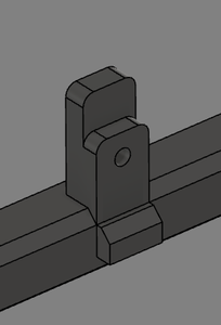

Attaching the guide rods
After the frame is printed, the 3mm rods are cut to size (about 1,5 cm) and press-fitted into the holes opposite the motor mounts. These are for guiding the worm shaft. They should only stick out on the inside.
Next, the motor mounts are glued to the frame. This can be a bit confusing, make sure they are properly aligned and appear straight in relation to the frame.

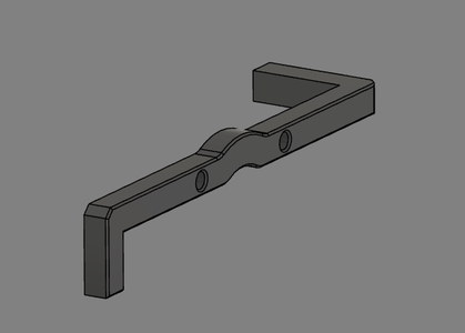

Connecting the mechanics
First, the flap is connected to the struts using the 3 mm rod. The strutsare then connected to the guide nut using the long M3 bolt and nut. Maybe use some washers here. These joints should be easy to move in order to minimize friction. Next, i screwed the worm shaft into the guide nut.
The flap can then be installed into the frame and fixed in place with the 4 mm tube. To do this, I screwed the M3 screws into the tube from both sides (it may also be possible to glue it).

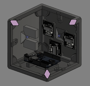

Step 4: Arduino Flap
On this Flap the Arduino is mounted (+ LED). I also used some Socket connectors on the Arduino pins to which i soldered the cables to improve strength.
In addition, a 3V button cell can be installed to store the RTC settings.

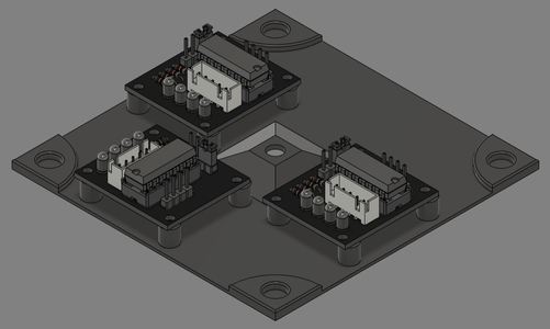

Step 6: Motor Driver Flap
On this Flap the ULN 2003 driver modules are mounted (+ LED). Unfortunately, the spacing of the holes was always a bit different, so there may be small deviations here. Normally one screw should be enought.
