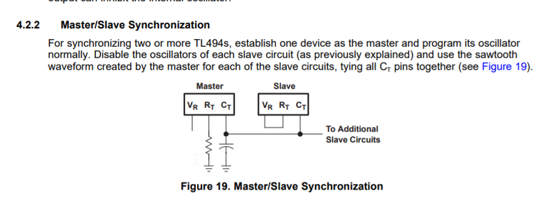

The idea of using the TL494 with a crystal oscillator came to my mind when I was going through the datasheet of the IC, which mentioned that the IC can be used in a master slave configuration such that the ICs can be cascaded together in such a way that one IC can control the operating frequency of the other ICs connected to it. I found tis very fascinating and began investigating more.

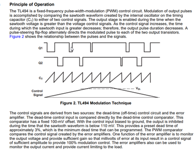

Basically the TL494 is a very popular PWM control chip used in a variety of switching applications and power supply circuits due to some of its useful features like :
  • Having two error amplifiers which can be used as a feedback mechanism in controlling the output voltage or limiting the current
  • Flip flop based output so that we have two alternatively switching outputs
  • external R and C component connections to determine the output frequency based on the RC time constant
  • Internal 5 V reference that can be useful for the error amplifiers
  • Adjustable dead time control between the output pulses
  • A good range of operating voltage
Phew, that was a lot and to get more information about this IC, I have attached the datasheet in this step for your reference.
Now coming to the signal generation, i have successfully generated a stable 50Hz and a 1Khz signal using the 4.096Mhz crystal using the IC 4060 which is a binary counter/ divider and a decade counter IC. If you are interested in how that circuit works, then more details are there in one of my previous projects the link to which is - https://www.instructables.com/Generate-Stable-50Hz...
The idea here is to use the binary divider ( IC4060) to generate 1Khz signal rom the crystal and then divide it by 10 using the decade counter IC 4017, in our case to get stable 100Hz which can then be fed to TL494 to generate two alternatively switching 50Hz signal at the output as from the datasheet it is clear that TL494 can accept sawtooth waves as input on pin CT when used as a slave. The deadtime can be controlled by applying a voltage between 0.7 to 3.3 volts which can change the deadtime from 3% all the way upto 100%. This can easily be controlled via a potentiometer. I have attached the snippets of those exact concepts in this step.

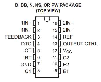

Well, the solution was to use a square wave of uneven duty cycle and directly feed it to the CT pin of the TL494 while the RT pin gets connected to the reference voltage as mentioned in the datasheet.

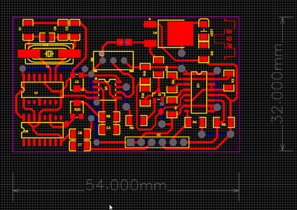

Step 7: PCB Layout
With successful breadboard testes, I got the green signal to move ahead with the PCB fabrication.
I have used Easy EDA to generate the schematic and the layout. You can use your favorite designing tool for this.
