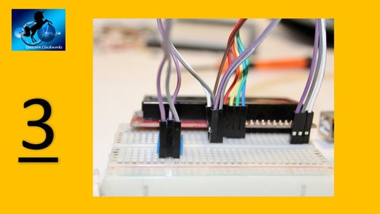

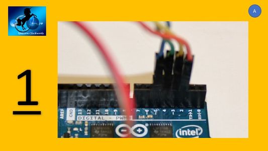

Step 2: LCD Connections
I made a very detailed instructable for this particular step previously which can be found here: https://www.instructables.com/id/Temp-1/ , but you can also follow the steps below without missing out on the details.
The connections are labeled in the picture and the wires correspond to the images are noted below.
1a
  • Connect the Brown wire (pin 16) to the GND pin on the Arduino
  • Connect the Red wire (pin 15) to the 3.3V VCC pin on the Arduino
  • Connect the Orange, Yellow, Green, Blue (pins 14-11) to pins 2 to 5 on the Arduino
  • Connect the White wire (pin 1 on the LCD) to the common ground (pin 16)
  • Connect the Grey wire (pin 2 on the LCD) to the common VCC source (pin 15)
  • Connect the Purple wire to the signal pin of the potentiometer (pin 2 on the potentiometer)
  • Connect the Purple wire (pin 1 on the potentiometer) to the common ground (pin 16)
  • Connect the Grey wire (pin 3 on the potentiometer) to the common VCC source (pin 15)

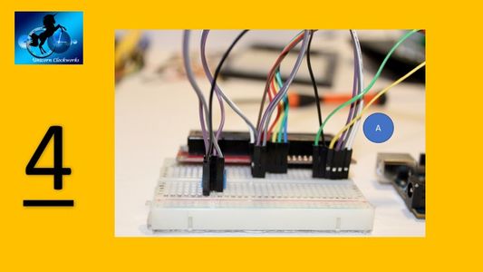

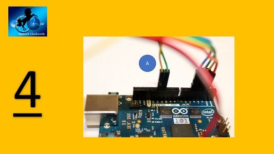

4
  • Connect the Yellow wire (pin 4 on the LCD) to pin 12 on the Arduino
  • Connect the Black wire (pin 5 on the LCD) to the common ground (pin 1 on the potentiometer or pin 16 on the LCD, either works)
  • Connect the Green wire (pin 6 on the LCD) to pin 11 on the Arduino

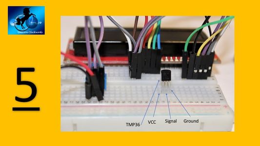

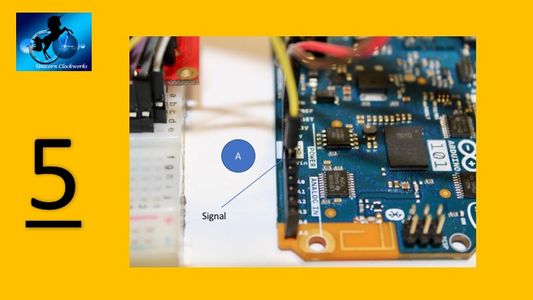

Step 3: TMP36 Connections
5
  • Connect the ground pin of the TMP36 -- pin 3 -- (as shown on the picture) to the any common ground (pin 1 on the potentiometer or GND on Arduino)
  • Connect the VCC pin of the TMP36 -- pin 1 -- to any common VCC source (pin 1 on the potentiometer or pin 2 on the LCD)
  • Connect the signal pin of the TMP36 -- pin 2 -- to pin A0 on the Arduino.

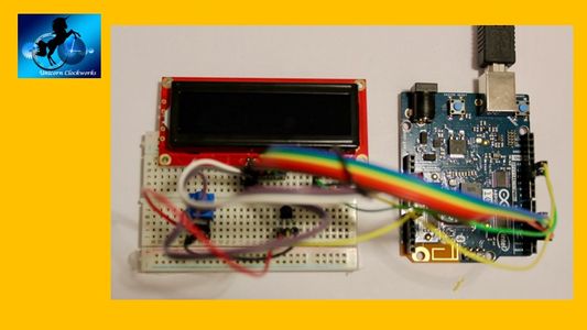

Step 5: It Works!
Upload the code to the Arduino and watch the display change. Test the sensor by touching it (make sure you have the polarity right so you don't burn your fingers.
Try it out yourself and have fun!
