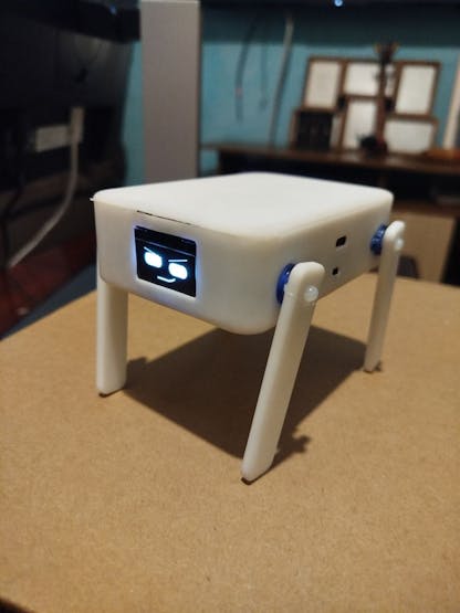

- 3D-Printed Casing: Durable, clean, and far more customizable.
- Cute Web Interface: Control your robot via browser with mood-based actions.
- Emotion System: TN-24 reacts with happiness, tiredness, or excitement based on how you interact.
- OLED Expressions: Displays animated faces that shift with mood or environment.
- Ambient Behavior: It wiggles when ignored, blinks curiously at you, or even plays animations on special occasions.

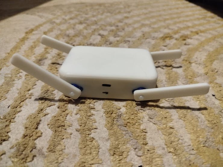

At the heart of TN-24 is the Xiao ESP32S3, a powerful and compact microcontroller that manages everything from servo movements to WiFi communication. It’s perfect for small form-factor robotics like this one, especially with its built-in USB-C, camera interface, and wireless connectivity.
Here’s what’s under the hood:
- Xiao ESP32S3 – The main brain of the robot. Small but mighty.
- 4x DFRobot Micro Servo Motors – These handle leg movements to create an expressive, animated walk.
- MPU6050 Motion Sensor – Gives the robot the ability to detect orientation and movement, making interactions more dynamic.
- 0.96" OLED Display – Used to show a wide range of animated eyes and emotions, giving TN-24 a personality.
- 3.7V Lithium-ion Battery – Keeps TN-24 powered while staying compact and rechargeable.

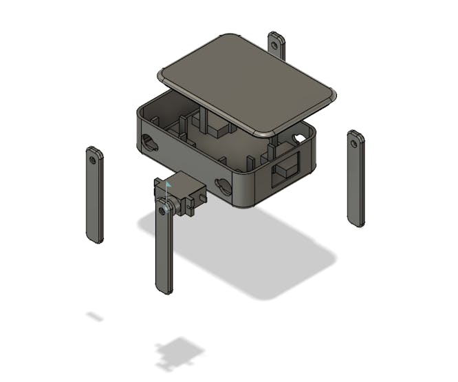

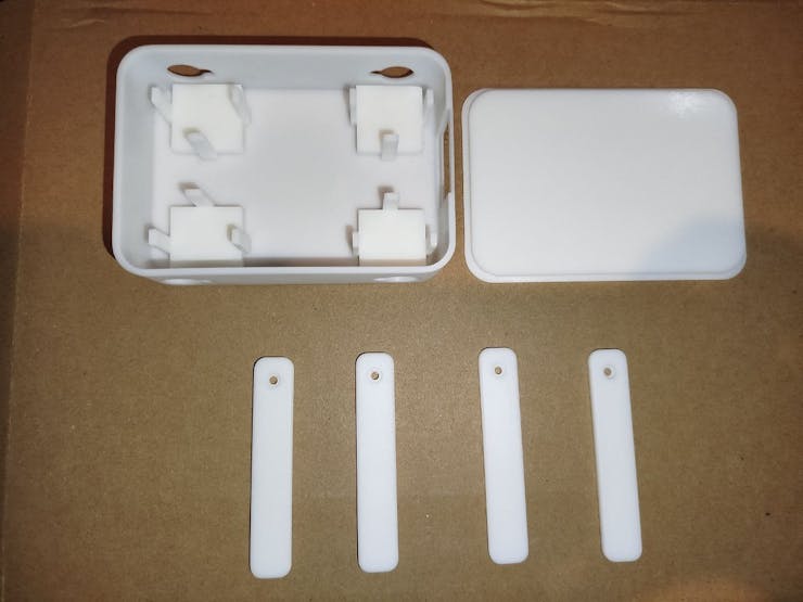

Step 3: Designing the Enclosure
For TN-24 V2.0, I wanted a polished, professional-looking design—so I moved away from the recycled cardboard of V1 and dove into 3D modeling using Fusion 360.
The process involved:
- Designing a compact and modular shell that can house all electronics snugly
- Creating cutouts for the OLED display, servo wires, and switches
- Ensuring the structure was lightweight enough not to strain the servos

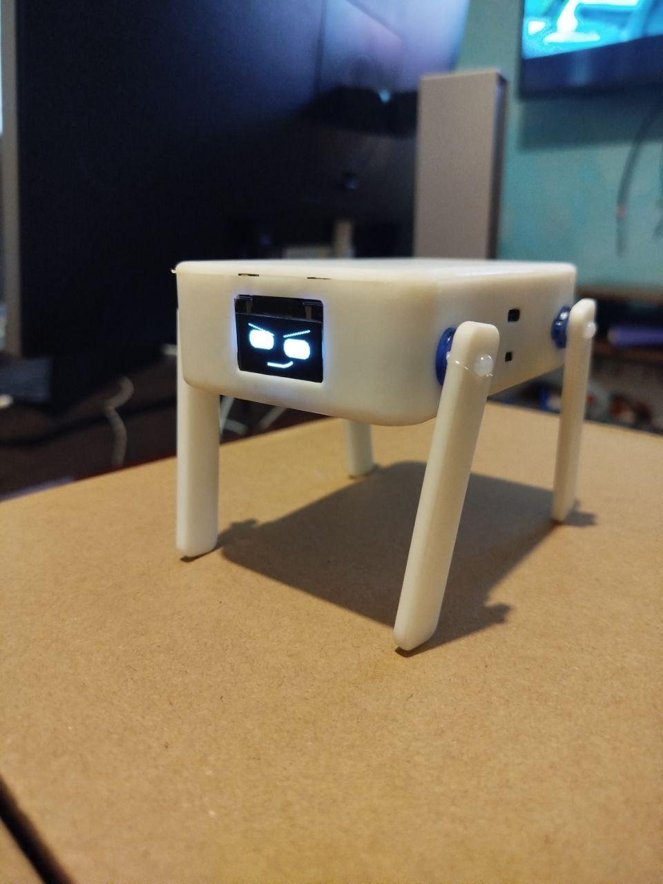

Step 4: 3D Printing the Case
To bring the design to life, I needed to 3D print the casing, but I don't own a 3D printer so I turned to JUSTWAY, who generously 3D-printed the casing for me. Their print quality is excellent, and I highly recommend checking them out if you're looking for high-quality, reliable prints. You can visit their website here: JUSTWAY. Ordering is simple you just upload your 3D files choose the material, color and finish you want.

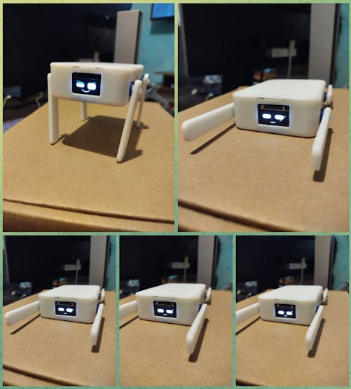

Step 6: Show & Tell
Final Thoughts
TN-24 V2.0 is more than just a walking bot, it's a digital companion that reflects your creativity, and hopefully brings a smile to your face every time you see it.
Whether you build it with cardboard or 3D-print a body like I did, it’s a project that grows with you.
