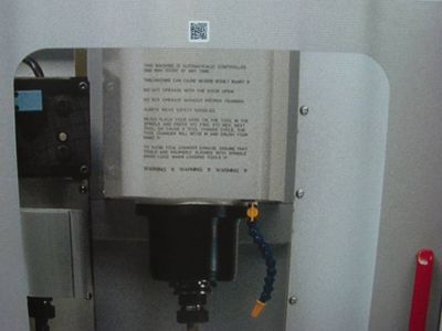

A beacon is a transmitter that notifies your smartphone when you are in its presence. Our simple solution is to print a small QR barcode and affix it to each machine tool or storage location.

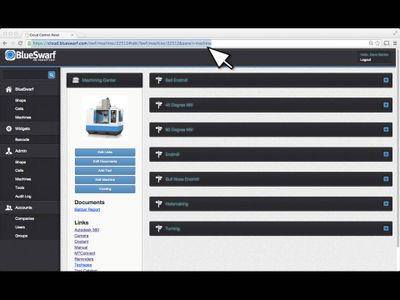

Step 3: Machine Webpage

This how you print a beacon label. Open to the desired machine page. Highlight and copy the URL.

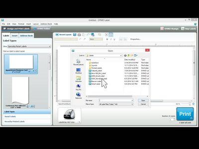

Step 5: ​Open the Beacon Label Template.
You can download it from this support page.

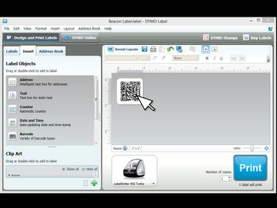

Step 6: Click on the QR Code Image

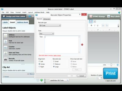

Step 7: Choose TEXT and Paste URL
Choose TEXT in the Data drop down menu. Paste the URL into the text box. Click OK.
Step 8: Print the Label.
