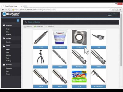

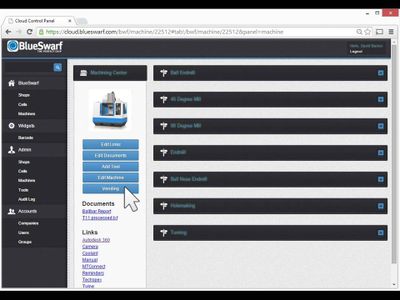

Step 1: Click the VENDING Button
Step 2: Click on the Item
Click on the blue button under the item.

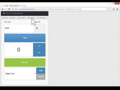

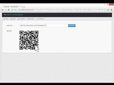

Step 3: ​Click on the "Barcode" Tab
Click on the "Barcode" tab at the top of the page.

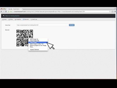

Step 4: Right Click on the Barcode Image
Step 5: Click “Copy Image“ From the Drop Down Menu

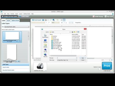

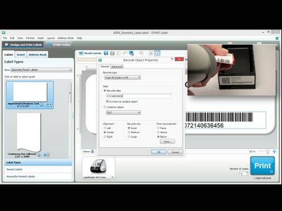

Step 6: Open Label Template and Dymo Software
Open the appropriate label template. You can download them from this Support Page.

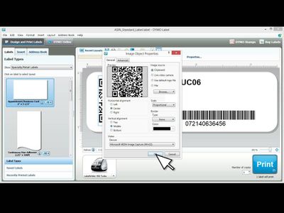

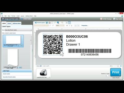

Step 7: Click on the QR Code on the Dymo Label Template.
Step 8: Click the Radio Button Next to "Clipboard"
Then click OK

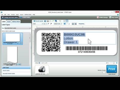

Step 9: Edit Text
Click on the text on the label template. Make sure the existing text is highlighted or delete first. Type a name, description, location or whatever you want to appear on the label.

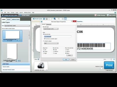

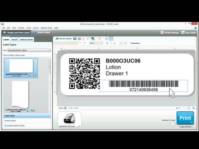

Step 10: Edit Barcode
Click on the barcode at the bottom of the label template.
Step 11: Highlight the Numbers in the "Barcode Data" Field.

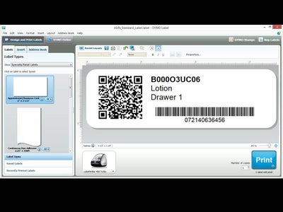

Step 12: ​Scan the Barcode/UPC Label
Scan the barcode/UPC label on the product's package. Click OK.
Step 13: Click "Print" Button
