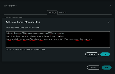

http://dan.drown.org/stm32duino/package_STM32duino_index.json
Put this in the additional boards manager list ( file -> preferences -> additional board manager )

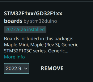

Now installed the specified board from the Boards Manager - STM32F1xx/GD32F1xx boards ( reference given in media)

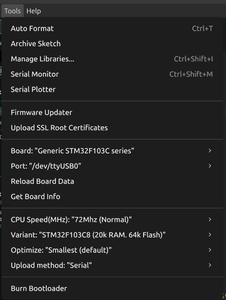

Go to Tools section and make sure that these options are selected as per what i have attached
Make sure that you have selected correct voltage level in the CH340 so that your board wont fry while programming the STM32.
If STM32 is of 3,3v -> connect the VCC to 3.3v of the CH340 programmer
After Connecting the programmer to your laptop, select the COM port and board as it is mentioned in the picture
Board Name: Generic STM32F103C

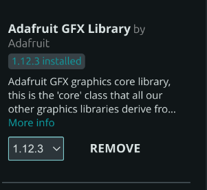

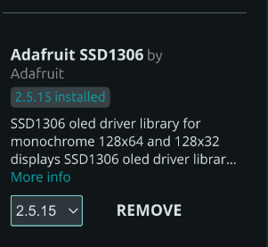

Make sure that you have these libraries installed in Arduino IDE in library manager tab
Adafruit GFX Library by adafruit
Adafruit SSD1306 by adafruit

Make sure that correct specs are set in TOOLS section while uploading as per the image.
Now verify and upload the code to STM32.
