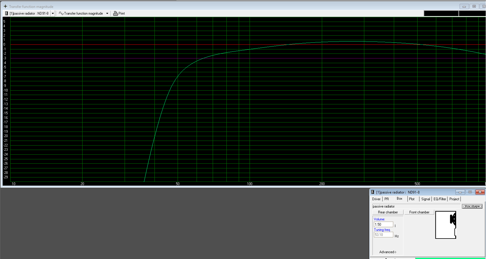

Simulations
WinISD PRO is a very handy program for simulating speaker enclosures. I simulated the box and drivers using WinISD to get a rough idea of what the frequency response will be. In order to boost the bass frequencies further, I included a Linkwitz Transform, a filter used frequently to extend the bass response of a speaker, and a high pass filter at a low frequency to protect the driver from really low frequencies. The final simulation is shown here:
The simulation project and driver files are here:

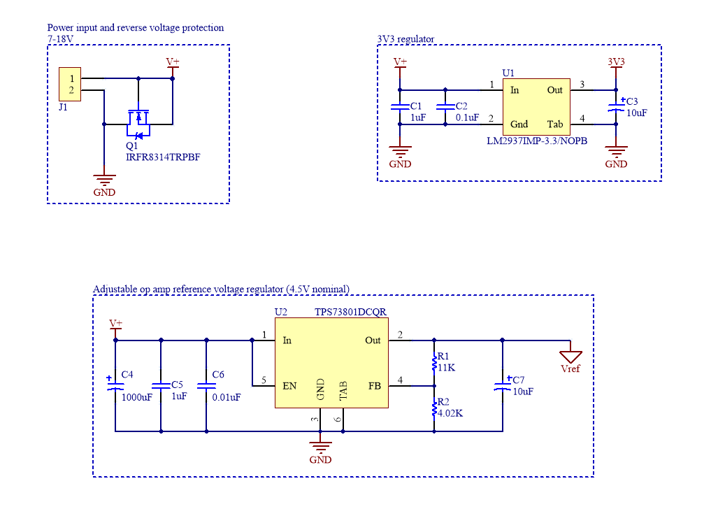

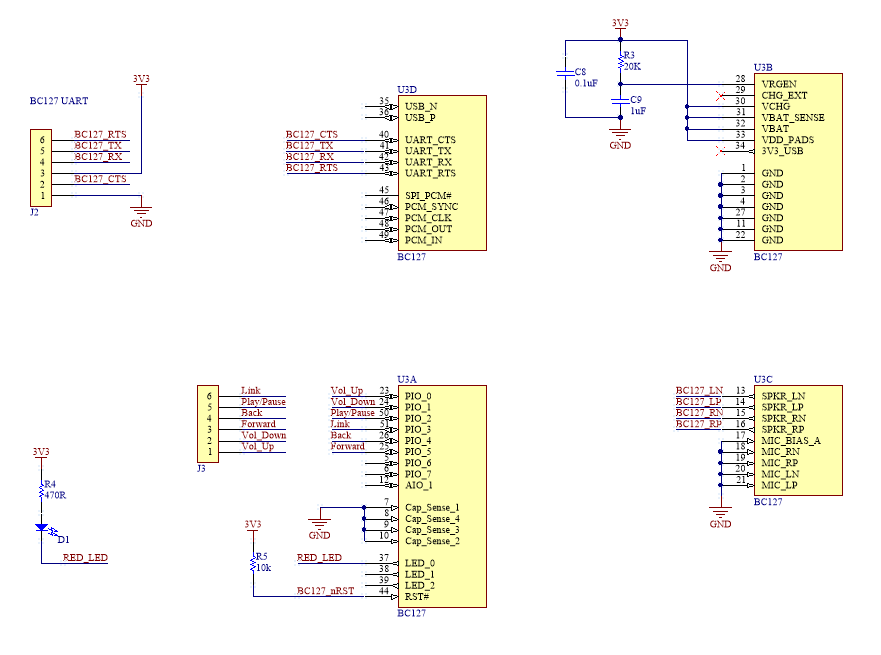

Step 3: Power Supply and BC127
Note: full schematic is attached as PDF.
Power Supply
J1 is the power input jack. I am using a terminal block so that I can swap power supply modules, but really any jack will do as long as it satisfies the voltage requirements. That being said, 7V would result in a very quiet amp because the operational amplifiers will clip very quickly, and 18V will cause too much heat dissipation from the linear regulators (U1 and U2). The sweet spot is around 12V. The circuit will theoretically work up to about 24V as the TPA3118 is rated to that voltage. However, make sure the capacitors are rated up to that voltage.
Since a linear regulator is effectively a buffered voltage source, it is perfect to use as a virtual ground/reference point for op amps. Ideally, this reference point should be about halfway between the power rail and ground. Regulator U2 is has an adjustable output, set by R1 and R2. The equation for calculating output voltage is:
(From the TI datasheet)
MOSFET Q1 is used as reverse voltage protection...just in case clumsy me inverts the power lines :P
A 1000uF bulk capacitor serves as a local voltage supply for the board, so that the circuit can draw a large current from a source without the power supply voltage dipping. Read this for more information about bulk capacitors.
BC127
The BC127 implementation is very simple, since we are only using it as an audio module. The UART interface is broken out to a connector to allow for firmware updates to the BC127. A commonly available UART-to-USB adapter is needed for this.
The IO pins for audio control is broken out via J3. A microcontroller or physical buttons can be connected to these.
R3 pulls up the VREGEN (regulator enable) pin of the BC127, which needs to be at a logic high for the module to boot. C9 is used to slow down the rising edge of that signal so that the power supply has time to stabilize before the module is booted (totally overkill).
The speaker out connections continue to the input section of the circuit on the next step.

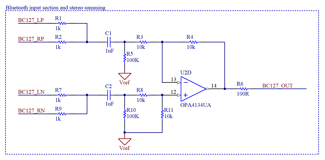

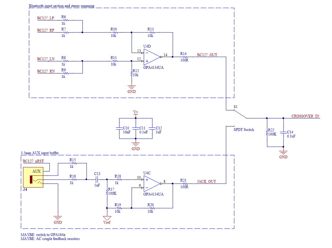

Step 4: Input Section
The input section serves several purposes. Since the speaker needs only one channel of audio, this sums the left and right channels using resistors. It also allows for switching between the jack or the Bluetooth module.
The jack buffer AC couples the input signal using film capacitor C13 - a good way to isolate the circuit from DC voltages from outside sources. This also biases the input signal to the reference voltage, VREF. Biasing refers to making an AC signal oscillate around a fixed DC signal - this is necessary for op amps to operate with only a positive power supply. The buffer is really a non-inverting op amp amplifier, so the gain can be adjusted using R19 and R20 if you want a louder signal.
The BC127 buffer converts the differential signal from the BC127 to a single ended signal that can be used by the op amp filters. It so happens that the inputs from the BC127 are already biased to 1.2V, meaning this stage will work even without bias. However, after building the board I realized that the BC127 could have been AC coupled for better performance as below:
This would be more effective at isolating the ground noise from the BC127 and also bias the output of this stage to the same voltage as the jack output.
A shortcoming of this circuit is the op amp choice - the OPAx134 family is only able to swing to within 1V of its rails - this means that this op amp will start distorting and clipping if the signal reaches below 1V or above 11V on a 12V power supply. If this circuit is to work at lower voltages (down to 7V) or if my first BC127 buffer implementation is used, the op amp starts clipping very quickly without much volume. Therefore, a rail-to-rail operational amplifier, more optimized for smaller voltage rails, should have been used.
Note that the 3.5mm jack symbol shows the 4th pin of a 4 pin JST PH connector used to connect the jack to the board (I had lots of them). These extra pins are conveniently used for sending non-essential signals off the board so that they can be accessed by devices not on the PCB. I do this for almost every PH connector I use here.
The output of the buffers connect to the input of the filter section in the next step.

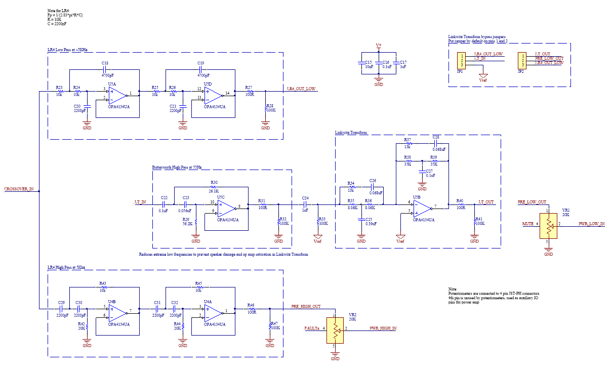

Step 5: Filter Section
Ah, this one is a mess :P
While this circuit looks complicated, it really is just a few small blocks put together.
I selected a frequency of 5KHz for the cutoff to the tweeter - plenty of room so that the tweeter isn't playing anywhere close to its resonant frequency of 2KHz. The crossover is a classic 4th order Linkwitz-Riley crossover. These cascaded 2nd order filters have a steep 24dB/octave slope. While I can write all the theory here I thought it would be better coming from the original creators or Rod Elliot of ESP. In short, these are high pass and low pass filters with a steep slope, made using op amps.
Following the low pass filter for the woofer is the interesting part of this circuit. A 2nd order high pass filter at 55Hz rolls off the really low frequencies. There's really not much audio below 50Hz so we might as well protect the speaker and the next op amp from trying to play too low.
Since a high pass filter cuts off all low frequencies, including DC, which is effectively 0Hz, the output signal of that stage actually ends up biased at 0V. Well, there goes all the hard work biasing this signal. Unfortunately this means we have to AC couple and bias it again to 4.5V, which thankfully isn't all that hard.
The next stage is the Linkwitz Transform, a unique circuit with with some complex math that acts as a bass booster. Usually used to correct low end roll-off in a non-ported speaker box, I am...misusing...it to simply get more bass out of this circuit.
Not knowing whether or not the bass cut and boost will actually help the sound of a particular speaker box, I left in 2 jumpers that bypass this section of the circuit.
The two channels of audio - now separated low and high frequencies, are connected to the TPA3118 via potentiometers as individual volume knobs for the tweeter and woofer.

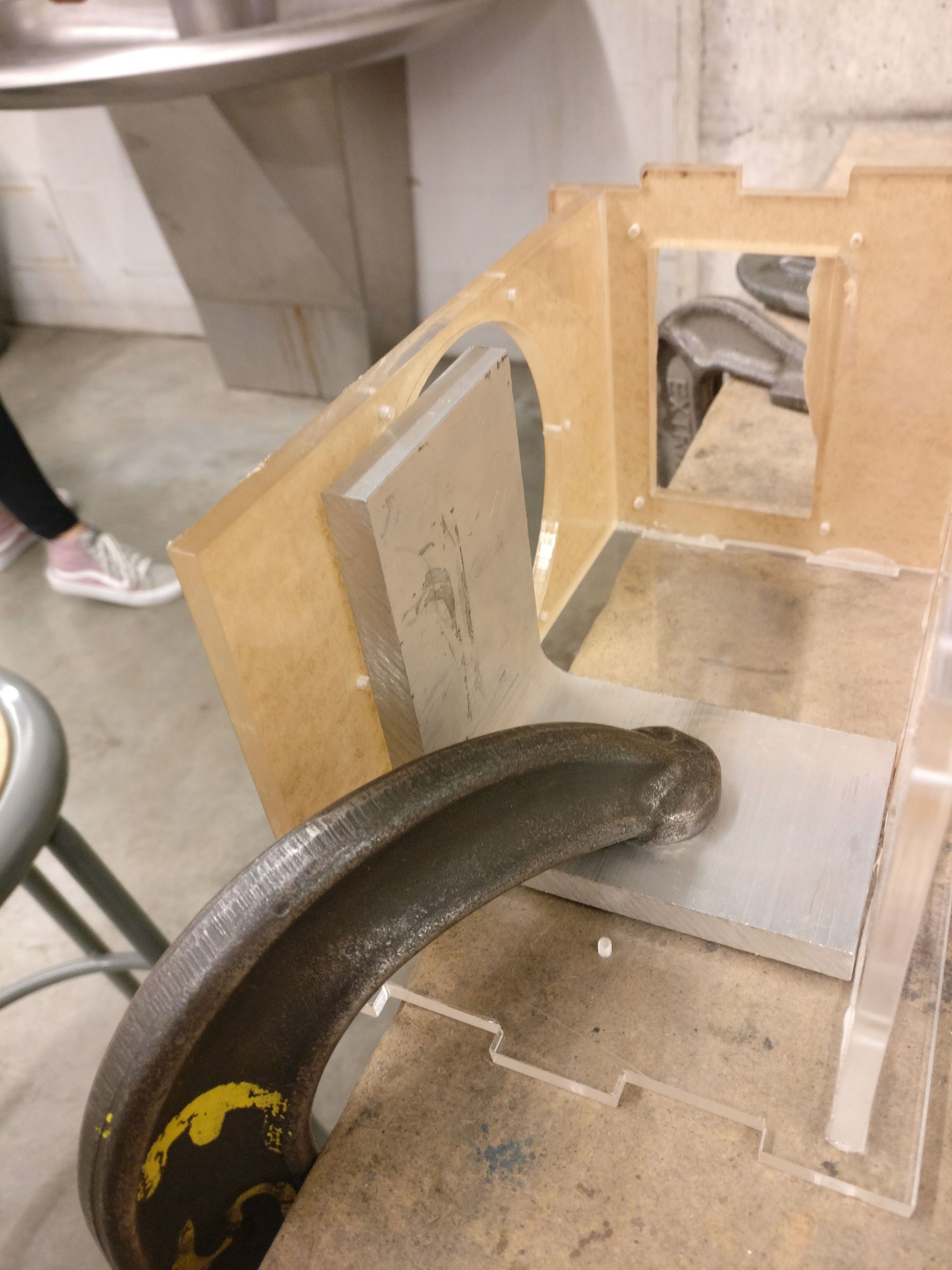

Step 8: Speaker Box
I designed a simple dovetail jointed box intended to be laser cut from acrylic. The .step file and .dxf files I used for laser cutting are attached here. The internal volume is about 2L without any components, so effectively it will be approximately 1.5L with everything in (the same as the modeled volume from before). The holes are actually only used for drill guides, and should be drilled bigger depending on the screw used. The top panel was originally going to be a conductive 3D printed capacitive touch panel printed on the Voxel8 Developer's Kit. However, I never ended up designing the microcontroller that was to use this panel. The side panel was purchased from DigiKey and is reflected in the BOM.
Note that laser cut acrylic has a bevel on the edge, meaning it is not entirely flat. I was concerned about using acrylic cement with this beveled edge, and so I used epoxy, which is not ideal for acrylic as it does not bond quite well. However, the box seems sturdy thus far although no drop tests have been done :D
A very handy piece of right angled aluminum I found was used in the gluing process to keep things square.
