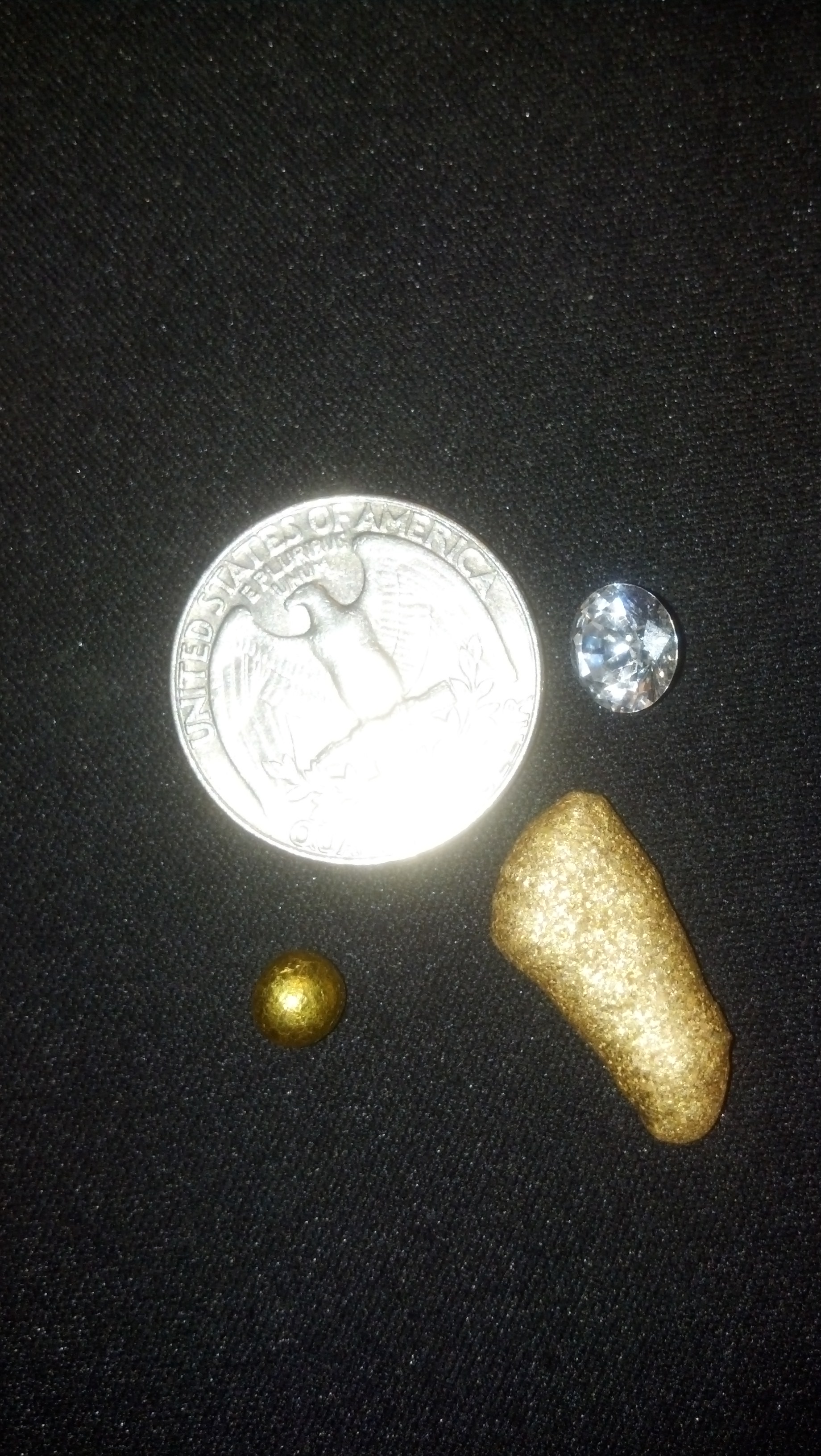

Step 11: Recovering Your Gold.
Recovering your gold in solution is one of the Coolest steps.
Whats needed, a plastic spoon, and the sodium Bisulfate or Stumpout.
Simply add very small amounts of stumpout, Your Mixture should start to look like the pictures I have provided. This is caused by the SO2 Gas which acts to chemically displace the gold in solution.
When the reaction has finished you will have driven out a majority of the chlorine, and replaced it with Sulfur. Any gold which was trapped in the solution has now be come a brown precipitate at the bottom of your beaker.
Retest with Stannous chloride, if your reaction still turns purple you need to add more stumpout.
It will take appox 10 hours for the gold to competely settle, the solution should be clear at this point.
Step 12: Melting
OK this is the last stop, At this point you have drained off the last ot the solution with your pipette the bottom of your beaker should be coated with what looks like dried cinnamon.
THATS PURE GOLD. Put that powder onto a fire brick that has been treated with a flux material like borax. Melt the borax till it becomes glassy. Apply your powder,
Heat with a MAPP torch or something more aggressive, careful not to blow your powder off the firebrick.
TADA Pure 24Karat gold.
