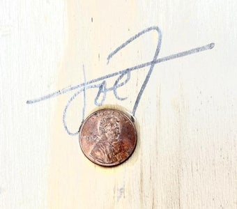

PENNY -trademark (rear of
board)

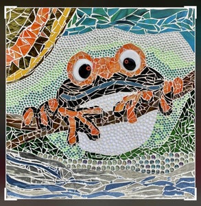

10. Next I drew out the TREE FROG 🐸 perched on a tree limb.
GO TO STEP 12 and 13 then proceed to step # 11.
11. I scored and cut the speckled green, gray, brown and orange glass to resemble the FROG and TREE LIMB. After the glass is laid out, remove a section at a time, spread the WELDBOND GLUE onto the wood section and then press in place all the glass pieces named in step #11.
NOTE: The TREE FROG eyes were made separately using a process of “fusing glass”. 12 A. Cut 2 eyeball shapes
using white glass.
B. Cut 2 pupils using BLACK
glass.
C. Layer each black pupil

21. Use attached photos to
help in this section.

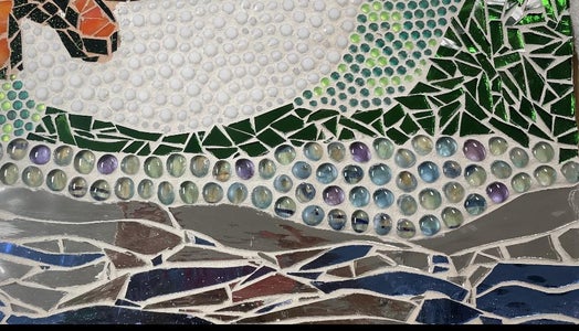

Step 3: GLASS BEADS - ASSORTED
WEAR SAFETY GLASSES WHEN SCORING OR SNAPPING GLASS BEADS
1. Lay out approximately 70,
3/8” - 1/2” glass beads,
horizontally above the water
lines. (Clear, purple, Light
green and light blue.)
2. Pick up beads, put glue
down and press glass
beads in place.
