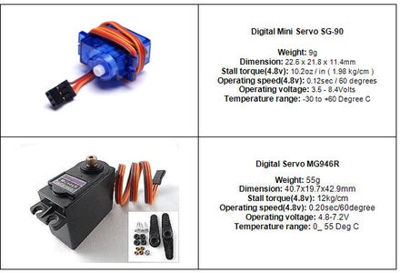

Step 6: Servos
The TROBOT uses RC (Radio Controlled) Servos:
An RC servo is controlled by a Pulse Width Modulated (PWM) signal -- Typically controlled by a 1mS to 2mS pulse that repeats every 20mS. 1.5 mS signal tells the servo to center, 1ms is full clockwise travel, 2mS is full counter-clockwise. Servos are available in many different configurations for the amount of travel possible. Some standard servos can move +/- 30º, some up to +/- 90º, some have full or even continuous rotation.
