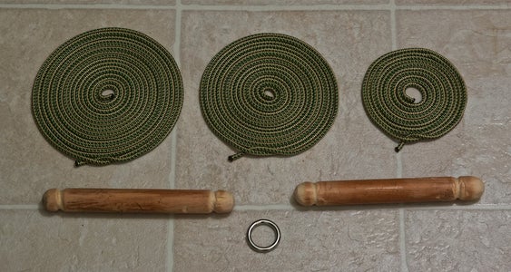

Step 1: Materials
- 10m of 4mm climbing accessory cord ($8), with a synthetic core.
- 2 pieces of broom handle or dowel for the hand holds
- (optional) 1 stainless steel ring, chain link, or climbing carabiner
Optionally, file a grove around each end of the handles. I think the constrictor knot that we use later works best if the grove is all the way around, and not just a dent in one side.
The ring reduces wear on the rope, but it is not necessary if you just want to try this out.

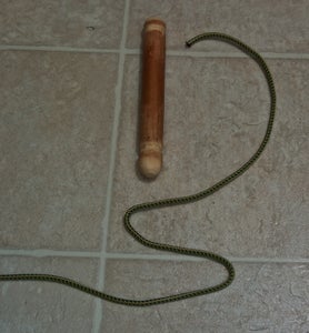

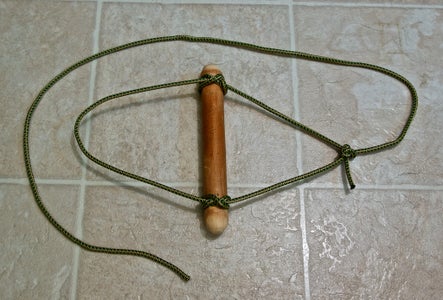

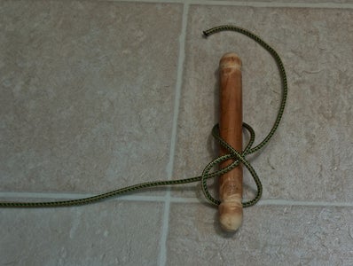

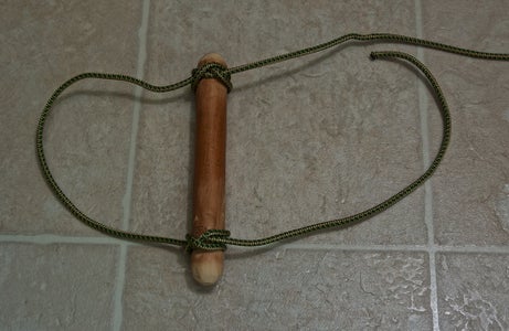

Step 2: Constricter Knot the Handles
Use the 2.1m rope for this step.
The Constrictor Knot is very easy to tie (for other instructions go to http://en.wikipedia.org/wiki/Constrictor_knot).
I did not check what happens if you don't do this, but I recommend you tie the two Constrictor knots in opposite directions. i.e. one starts as a normal "S" and the other starts as a backwards "S". if you do this right, the two constrictor knots will mirror each other.
Look at the pictures!

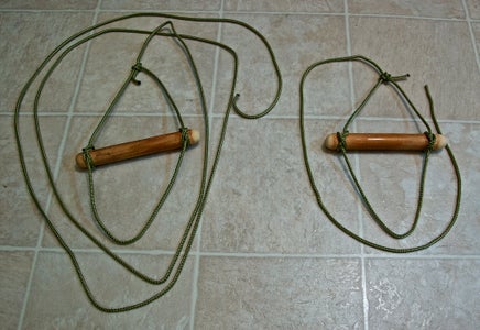

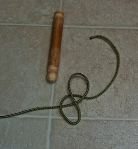

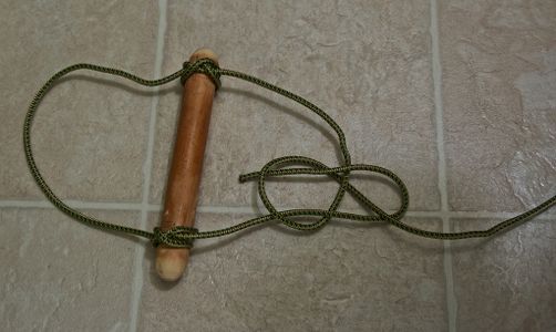

Step 3: Finish the Handle With a Bowline!
The Bowline is the most important knot anyone can know. Do it exactly as shown. (more on the bowline: http://en.wikipedia.org/wiki/Bowline)
You can hang a truck off a bowline, and then untie the knot with your hands afterwards (provided the rope does not break!).
Adjust everything so it's nice and even, and you have about 6-10cm of rope protruding from your bowline.
You are done with the first handle! Repeat this for the 4.3m rope.

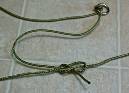

If you are using the optional ring, pass the longer rope through it twice, and bring the ring near to the handle, as shown.
Use a Sheet Bend (http://en.wikipedia.org/wiki/Sheet_bend) to create the main adjustment of your TRX. DO IT EXACTLY AS SHOWN AND GET TO KNOW THIS KNOT. (guess what, it's pretty much the same as the Bowline)
The shorter, 2.1m rope makes the loop of the sheet bend, while the longer, 4.3m rope makes the "U" turn. Leave about 6-10cm of the shorter rope, protruding from the loop.
