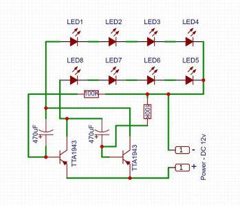

Step 4: Schematics and PCB Design
The schematics of PCBs can be seen above.

Step 6: Connect Capacitor With Transistor
To make this LED flasher circuit, 1st we connect capacitor positive leg with "Base" leg of TTA-1943 transistor and make same connection with the rest transistor and capacitor.
Then connect capacitor negative leg with another transistor "Collector" leg and again make the same connection with the rest capacitor and transistor.
Step 7: Connect Resistor With the Circuit
Now we need to connect resistor with the circuit. 1st we make a series connection between this two resistor. Then we connect these two resistors two empty terminal with both transistor "Base" leg.
Step 8: Connect LED With the Circuit
From these two pieces 12v led light, we got three terminals. We got two separate positive terminals and one common negative terminal. We connect two positive terminals with "Collector" leg of two transistors.
Again thanks to JLCPCB for best quality PCBs.
Step 9: Connect DC-12v With Circuit
For power source, now we need to connect power supply with the circuit.
For power source you can use 12v battery or 12v adapter.
Connect DC-12v positive cable with both transistor "Emitter" leg and connect DC-12v negative leg with 12v LED negative leg.
