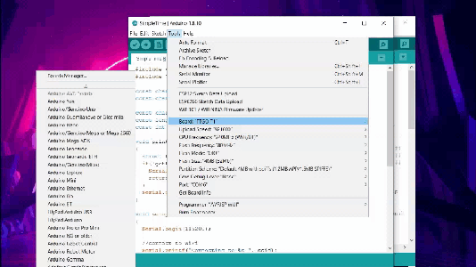

Before starting this project, you require ESP32 Boards core installed on Arduino IDE which is a necessity. Install them from here- https://github.com/espressif/arduino-esp32
So first, open SimpleTime sketch which can be found in
Example>ESP32>Time>SimpleTime
It's the generic internet clock sketch that we will use as a base sketch.
Our goal here is to Display the time which is in the serial monitor on TTGO's Display and for that, we have to change a few lines of code in this sketch.
  • We first add our SSID and Password in this sketch.
  • Now we have to add gmtOffset_sec which can be found from here. for example, I live in India and GMT here is +5:30.
  • +5:30 in seconds is 19800s so we add 19800 in the GMT offset
Next is the daylightOffset_set, if your country has daylight saving time then set it according to that time in seconds, and if not then set it to zero.
Find out about the daylight saving time from here.
  • Plug your TTGO board
  • select the right board in the Board manager
  • select the right port
  • hit upload
  • now open the serial monitor and you will see the current time printing repetitive at an interval of 1 second.

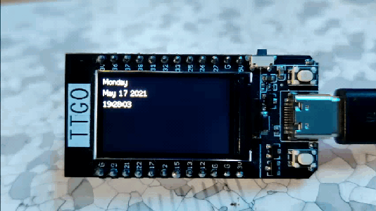

Step 2: Internet Clock Sketch for TTGO T Display
The previous sketch was the basic Internet time sketch, for displaying that on the TTGO T1 board, we only have to use a simple function that lets us display anything on TTGO's display.
But before that, you need to install this library which is a TFT Display library that we require for this task.
We first add the TFT_eSPI library and other important lines of code which is required to print anything on the display.
  • hit upload

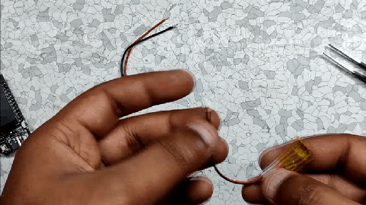

Step 3: Lipo Cell for Powering TTGO

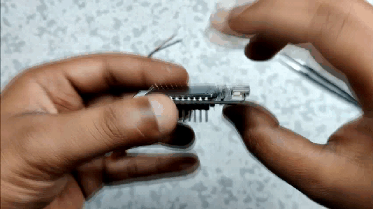

As for the battery, I used a 3.7V 500mA Lipo cell which I have salvaged from an old project.
I have to change the connecting wire of the LiPo cell to a smaller connector wire which was included with the TTGO T1 board.

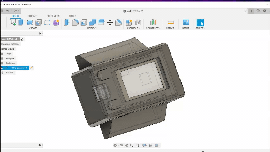

This was the basic setup for this watch project. Next is to design a Body for this setup. For that, I will be using Fusion360.

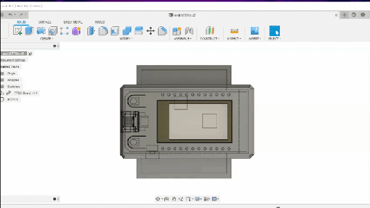

Step 4: Custom Body Concept
I designed this Body for the TTGO board which looks like an M5StickC board, the 3D Model for this TTGO Board was downloaded from grabcad user MIMOSA
For now, I haven't decided on the wrist strap for this project, I will probably buy the generic leather strap for this project as well. This is all for part 2 though, the basic setup of this watch project is this, a TTGO T display board hooked up with a LiPo Cell which displays the current time and date on its DIsplay and this all is enclose nicely in a 3D Printed Body.
