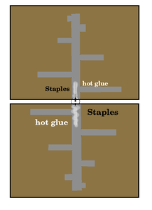

Take the 8x11 pieces and, with a ruler make a mark on de middle of the 11in side. Glue the foil pieces that you cut and glue them onto the card as shown.
Step 4: Add the Cable.
Use a pair of scissors to cut of one of the ends of the coaxial cable, the end of the cable must be the one that doesn't connect to the receiver! Use the scissors to strip the ends of the cable ( the end of the cable must look like the picture). Then use the stapler to staple the each group of wires to each of the 8x11 cardboard pieces (as on the 2nd picture). After staple the inner core to one of the sheets and the outer copper wires to the other sheet, use the hot glue gun to properly fix the cable. The two aluminum sheets must be insulated from each other!
