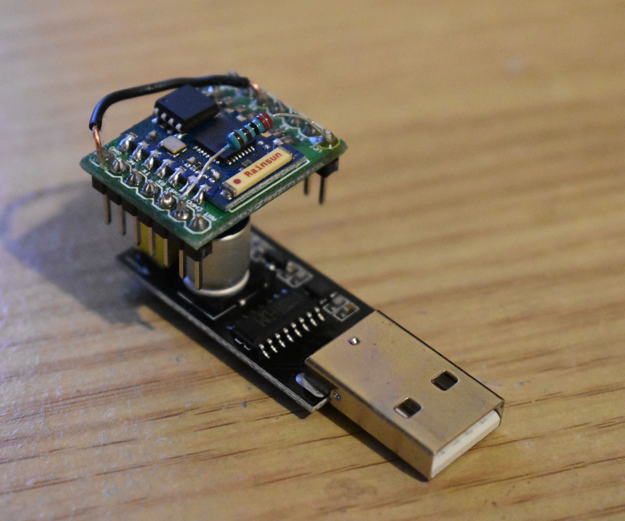

Recently I thought about shrinking my TV B GONE which I made by myself using originall Adafruit schematics and their firmware 1.2 (include EU codes)
I saw many projects on the Internet but only a few was designed for use with European on/off codes. (Yes, I'm from Europe - Poland)
I found dark sponge's projects. Especially I found this one very helpful https://www.instructables.com/id/350-DIY-TV-B-Gone-Mico/
In the last 20'th step he did some upgrade to work with original adafruit firmware v1.2.
I did my own schematic mainly based on his.

Step 3: Work on Schematic and Board Layout
As you can see I decided to use 3 IR LEDs. I didn't use capacitor between VCC and GND and I deleted external oscillator. I also decided not to place PNP transistor on board. (BC556 - popular in Poland)
I connected it with jumper wires to certain (corresponding?) points on PCB.

Step 5: Programming Attiny85
That was tricky. First I soldered wires to Attiny85-20SU and then through breadboard I programmed it.
Download FIRMWARE V1.2 from original project page https://learn.adafruit.com/tv-b-gone-kit/download
Burn hex file into microcontroller with your programmer. I used USBasp and AVR Burn-O-Mat
Remember to program fusebits to internal 8MHz clock.
1. Browse for firmware .hex file
2. Write hex to uC.
3. Go for FUSES
4. Make selections as mine.
5. Write Fuses
6. Done

Step 6: Solder Parts to PCB
Solder all SMD parts, then IR LEDs and then transistor and battery pack.
I decided at this point to add slideswitch on GND line between battery and PCB for battery saving purpouses.
