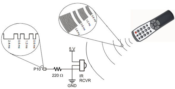

Step 1: Theory
Infra-red remote works by sending a stream o binary data, this is achieved by turning on and off an infra-red light at a high frequency(38.5KHz). This signal is detected by a receiver that contains photo-sensitive cells. The binary data is fed to the microcontroller which interprets the data and performs an action. We can see this data in decimal or hex or in other number systems.
I would highly recommend you check the details about this from an article by London's global university LINK

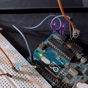

Step 2: Connect the IR Receiver to Arduino Board
With the theories out of the way, let's connect the IR receiver with Arduino and determine decimal codes for remote buttons. In this step, we check if the IR sensor works correctly and record the decimal values that correspond to our interested remote buttons.
Connections:
IR signal ------> Arduino pin 2
IR GND ------> Arduino GND
IR VCC ------> Arduino 5V
Arduino ------> PC

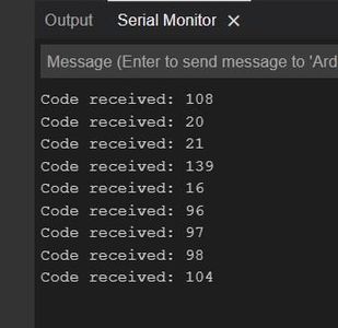

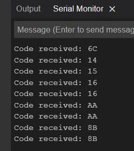

Step 3: Determine IR Received Data
We utilize the library IRremote.h to communicate with the IR receiver. This library is really useful in making our code simpler. After connecting the sensor upload the program and open the serial monitor.
You should see some value on your screen as you press the buttons. You can either see them as decimal values(pic 1) or in hex form(pic 2)
Note: if nothing appears on the serial monitor, check the connections. Reversing the 5V and GND pin of the sensor can burn the sensor.

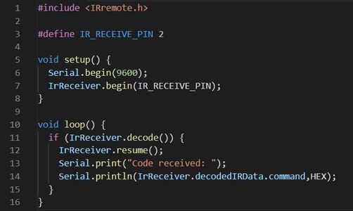

Step 5: Code
The full code has been added below. Comments after each line are added to understand how it works.
Tweak the code to add or remove features!
Step 6: Build the Circuit on Breadboard
In this stage, we build the circuit on a breadboard to see if everything works properly. It is suggested to build the whole circuit on a breadboard before soldering everything on a Vero board.
Be careful while testing and while connecting the TRIAC

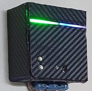

Step 10: Success
Finally, I used carbon wrapping paper to give it a nicer look. check the video below of real-life application.
