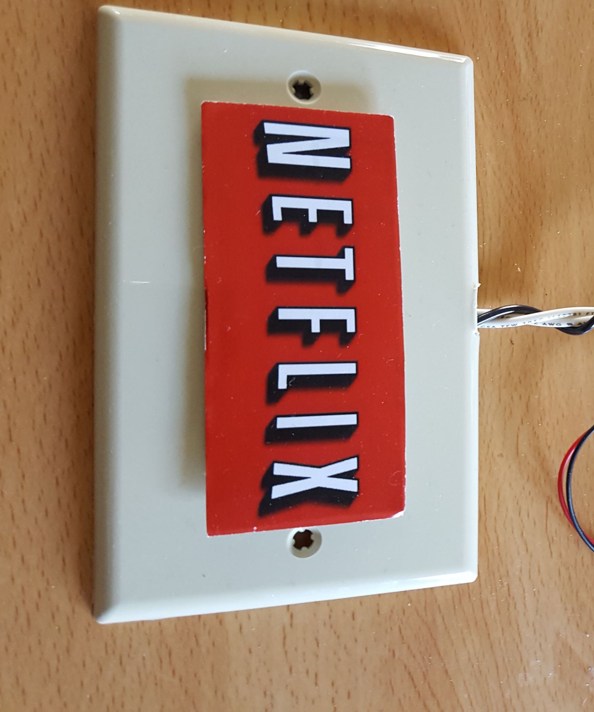

Buttons ( I started with push button and upgraded to capacitive touch)

Step 4: Finishing the Build
Once the arduino is wired like the schematic shows, remove the light switches. Remember to turn off electricity in the room you are working in. The leads that went into the light switch now go into your relay. In theory, you should be able to draw power required for the arduino from the same wire going to the lights, but I didn't want to risk messing it up so I drew power from a nearby outlet. For the final result, I swapped out the push buttons with capacitive touch buttons with tin foil on them for extra working area. I also made a box from leftover laminate flooring. I hope you enjoyed this project. I absolutely love using it and hope you will too.
