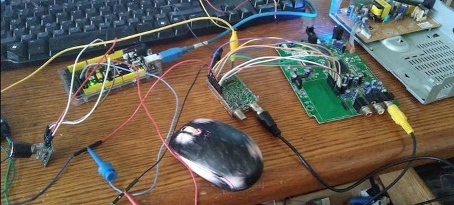

So for this project, I got:
Digital TV tuner to receive digital TV broadcasts and an analog TV tuner to receive FM radio and from Sony it transmits at 915 MHZ, I did manage to tune to civilian broadcast radio through the analog TV tuner by using an amplifier antenna, I did hear the truckers driver because my house is close to the highway, Sony cassette as my audio amplifier.
I did program everything using visual code IDE and platform IO.
I did explain the phase-locked loop in detail in another Instructables project.
and I did explain the vacuum fluorescent display in detail in another Instructables project.
I got Digital TV box from goodwill store for $6 and sony sounds system transmiter for $7 it transmit at 915 MHZ,and analog tv tuner from an old tv, old Sony cassette,two vacuum fluorescent display from old device, sound analog multiplexer ic from an old tv, two IR receiver from old device, old printer power supply 32v to power the vfd,old transform to power the cassette,old tv remote control. Two Arduino nano and arduino seeeduino xiao microcontroller. Three SN75518 shift register for the two vacuum fluorescent display.
