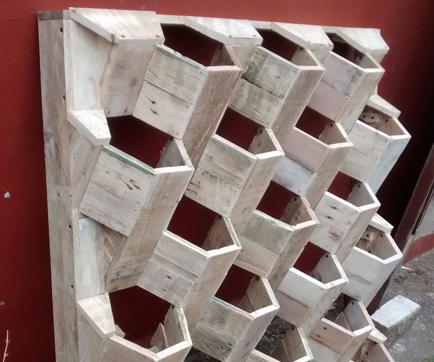

Now that you have a table-saw (even if it is a jury rigged version), you can do all kinds of neat stuff. Well, you can make lots of repeatable cuts quickly.
All of the cuts for the images on this step were produced on the table-saw, using various sleds and jigs. This was significantly quicker than cutting them by hand with a miter saw, but putting the table-saw together probably took more time than I saved for this project.
Using a sled allows you to measure once for many cuts, as you can clamp a bit of scrap to the sled, giving you something to push material up to before cutting. Be careful with the clamps you use, and keep them well out of the way of the blade. Angled sleds can be dangerous because of this.
