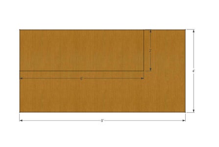

Step 1: Step 1: Cutting the Boards
Step 1:
- Gather at least 3 2x4s and cut 1 in half, 1 in 3rds, and 2 4-foot pieces out of the other.
- Cut ONLY ONE 4 foot piece in half.
- Next use your tape measure and go along the longest side of your plywood, measure 6 feet, then mark it, do the same to the parallel side.
- Then run the chalkline between the two points that are parallel,
- Then, on the short side you started at on the first one, measure out 2 feet, then make a mark.
- Then, on the line you previously made with the chalk line, measure 2 feet parallel to the other 2 feet and make a mark.
- Snap the chalk line between the two marks.
- Then run the Circular saw, that ironically will be attached to it later on, and cut along them chalk lines. You could attempt to use a handsaw if you have nothing else to do.
The plywood should be a perfect rectangle now and ready to be 'carved' in the next step.
