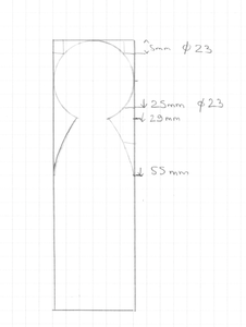

Step 4: The Skittles
My skittles are not clones...more sisters and brothers but with a few references for the position of some cuts it is not so hard to have nine skittles that look alike.
The piece of 2x4 dedicated to the skittles is cut in nine pieces of 10 cm
Progression :
  • turn a cylinder
  • mark some known diameter of the head and body
  • turn down to the known diameters
  • continue shaping to the final design
  • sand

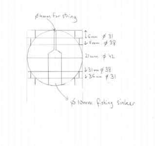

Step 7: The Ball
As for the skittle heads, diameters on various ball part are measured, it helps turning a symmetrical and almost spherical ball. Result is good enough (this ball does not need to roll...)
Pine wood is very light and the first test results were disappointing... the ball was almost bouncing on the first skittle it hit and I could barely have three skittles down on a throw.
Easy adjustment, I gave it some weight with a 15 gr fishing sinker (see pictures).
Progression :
  • turn a cylinder (longer the diameter of the final ball, one part is lost in the chuck, and free space between the chuck and the ball is more comfortable)
  • mark some known diameter of the sphere
  • continue shaping to the final design keeping a small attachment to the chuck.
  • drill a hole for the string
  • sand
  • remove from the lathe
  • drill a hole to the fishing sinker insertion
