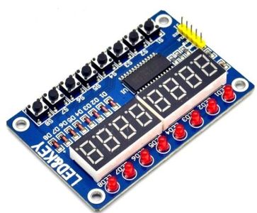

For this counter you need the led&key module. This is a cheap arduino module with lots of possibilities.
It uses 3 control pins (SPI) and 2 pins for ground and VCC.

Step 1: Led & Key Module - TM1638
The Led & Key module
This module is very cheap and has a lot of functions. There are 8 keys, 8 red leds and 8 digital led numbers.
For using it, it has to be connected to an Arduino or other microcomputer. There are 5 pins which has the following connections:
- VCC – 5v from Arduino
- Gnd – GND from Arduino
- STB – strobe pin, an output from your Arduino
- CLK – clock pin, an output from your Arduino
- DIO – data pin, another ouput from your Arduino
