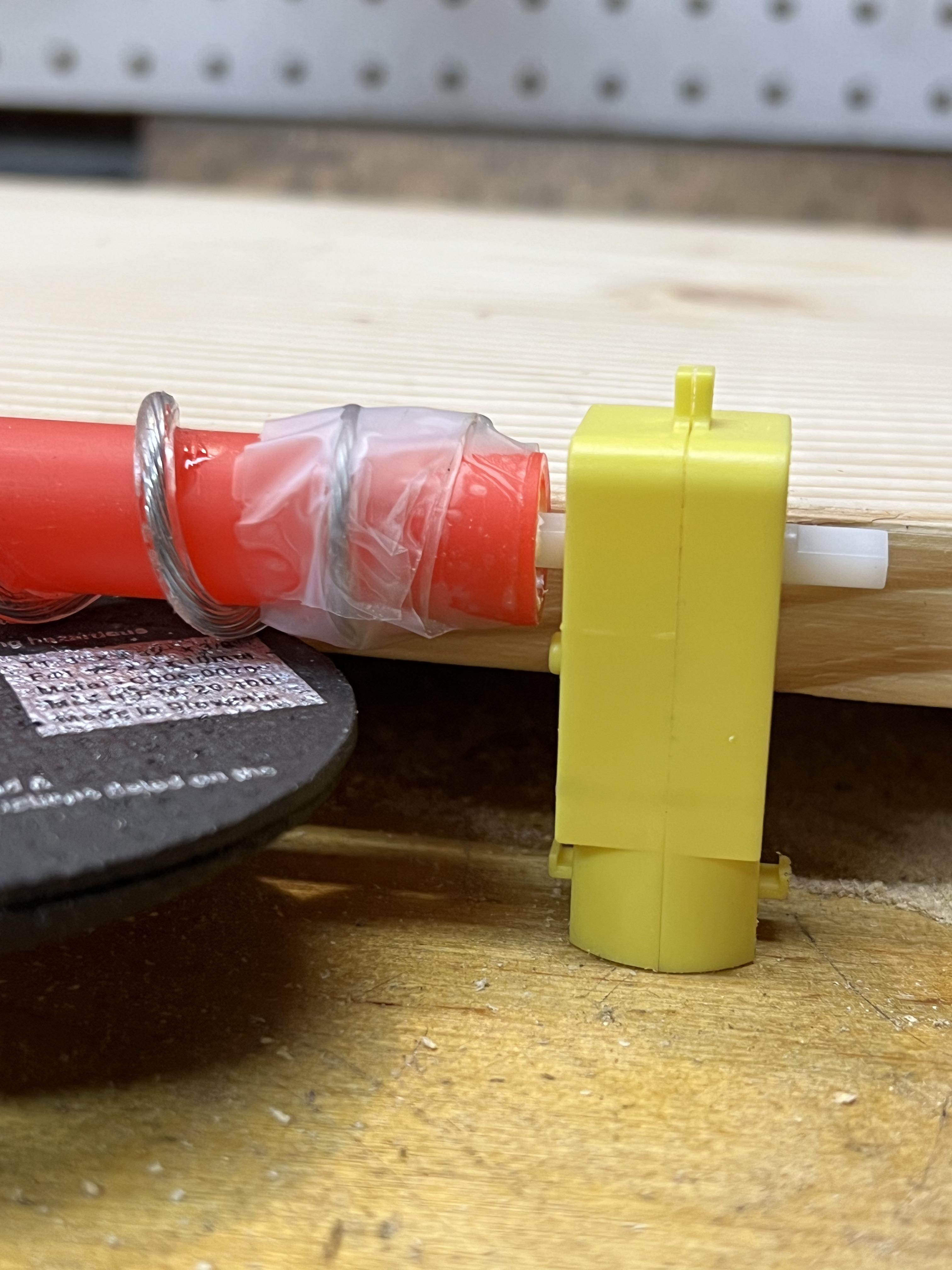

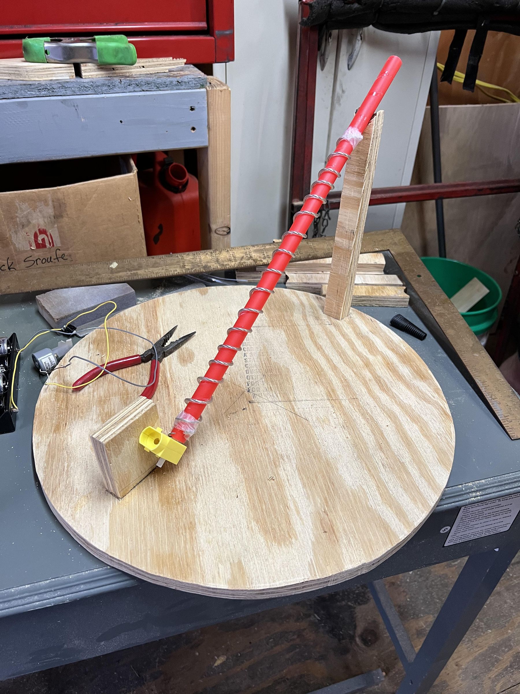

- Take the rigid plastic tube and securely fix one end. This can be done using a drill (which is advised) or by clamping it down. The other side of the tube should be supported.
- Take the plastic encased steel wire and wrap it around the rigid tube, keeping a pitch of 1".
- Tape down the ends of the wire and apply instant adhesive to keep it in place. Applying heat may also help, but too much heat will melt the plastic on the wire and the rigid tube!
- Once the glue has set and the wire is properly in place, cut the tube down to the proper length, using a wire cutter for the wire and a hacksaw for the tube.
- If the wire comes loose again resecure the loose end and reapply the glue.

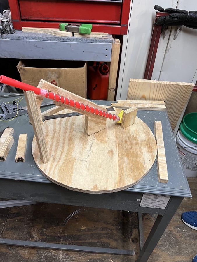

- Put the shaft of the motor housing into the hole of the rod. Make sure to keep the shaft directly in the center of the diameter of the rod to ensure that the Archimedes screw rotates uniformly. Take a 1/16 drill bit and drill a hole through both the rod and the shaft. Place a small pin in the newly created hole to hold the Archimedes screw and the motor shaft together.
Step 2: Building Base Plate and Adding the Archimedes Screw

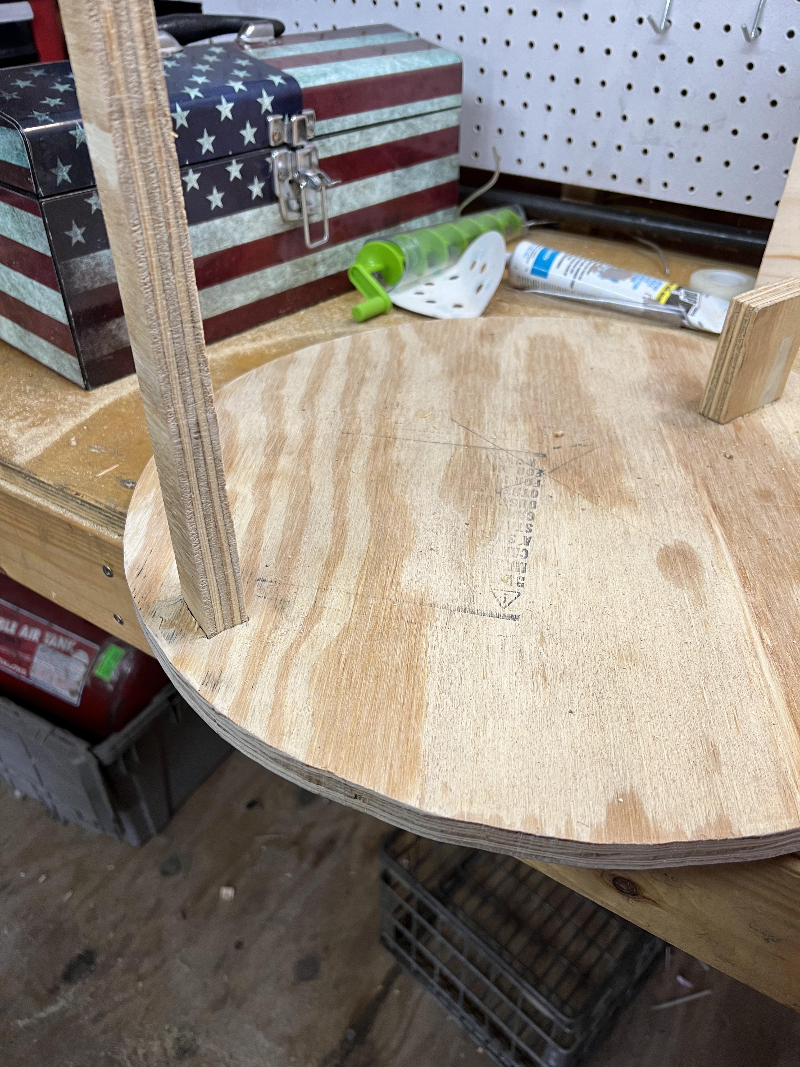

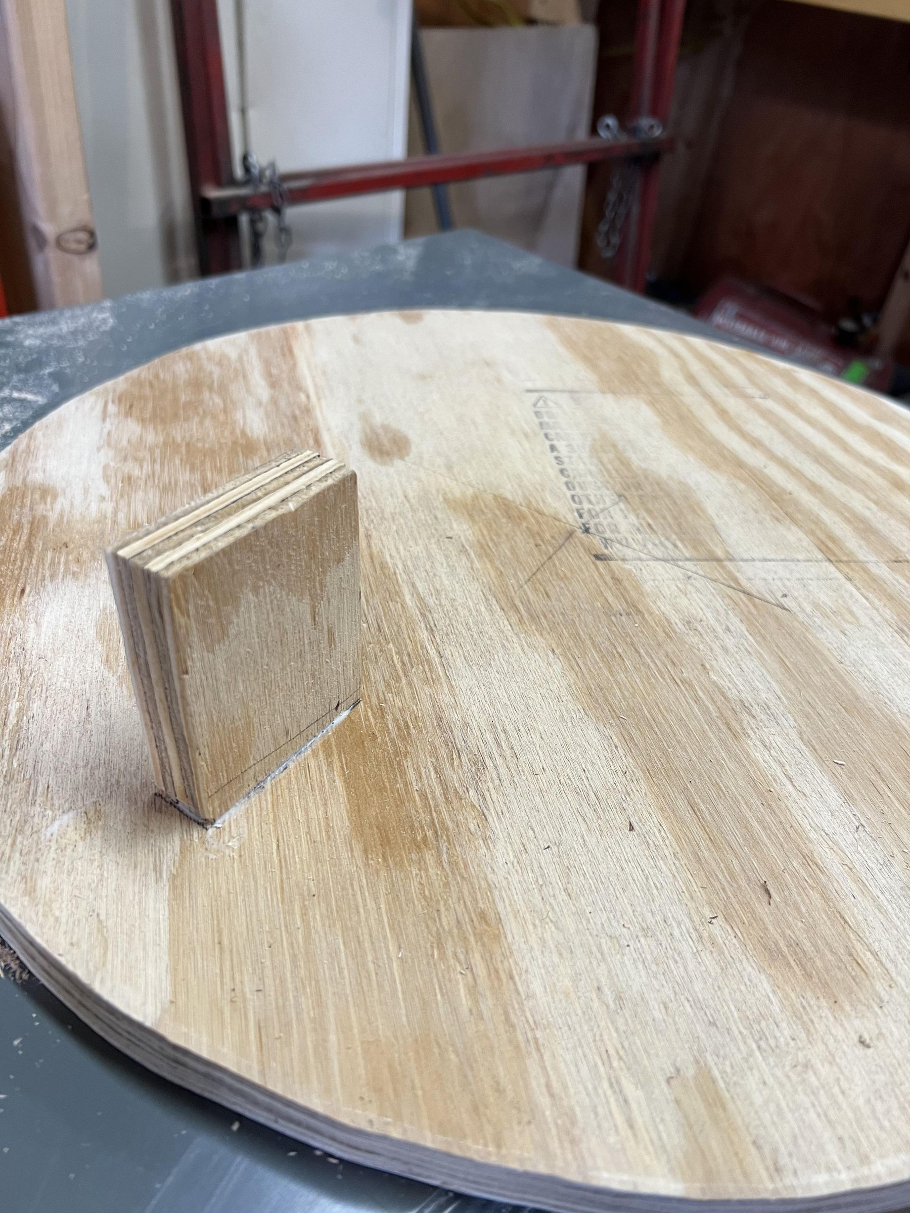

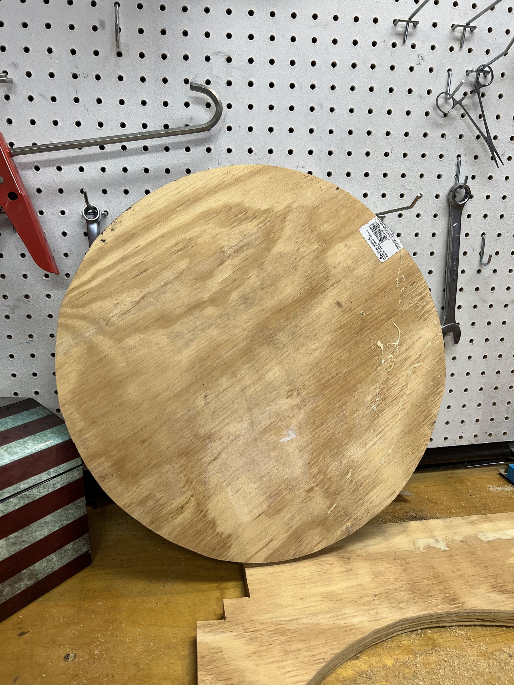

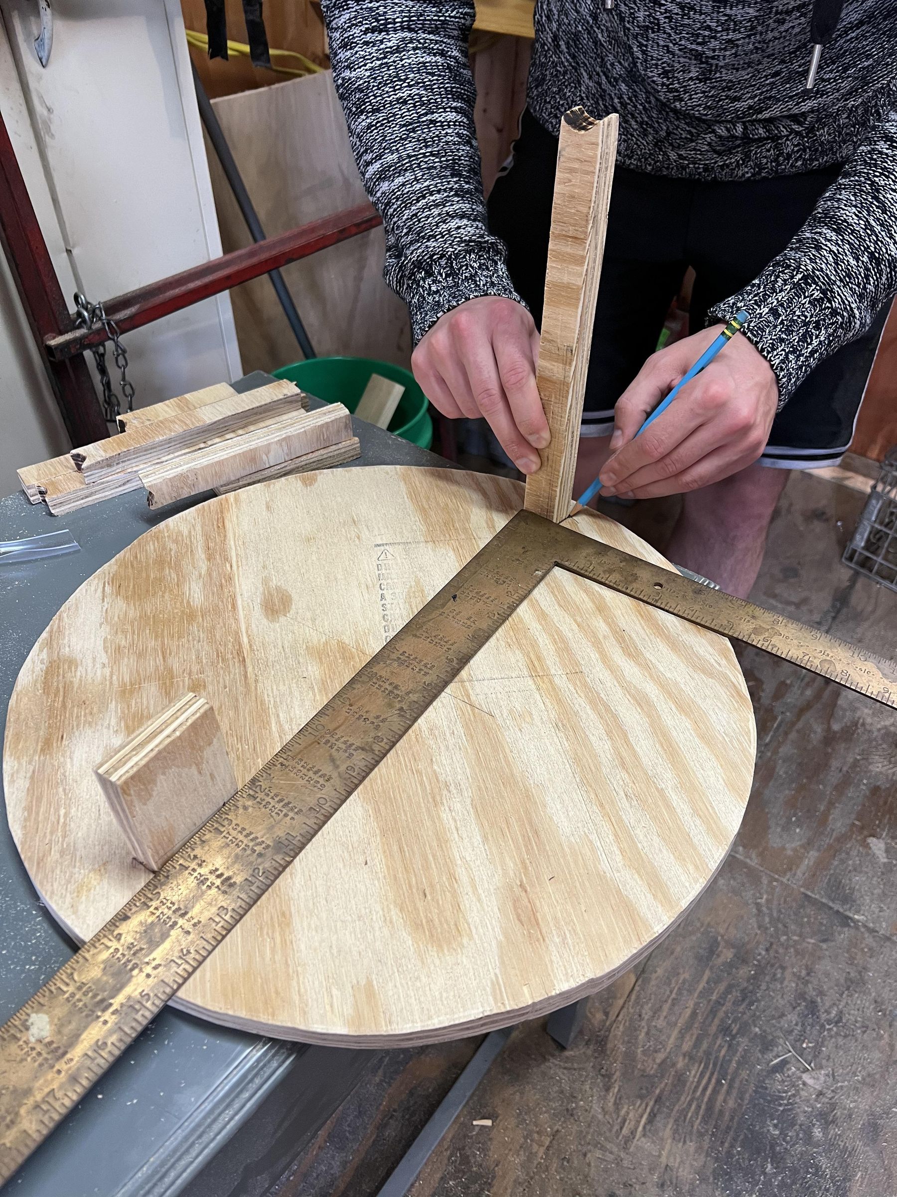

- Cut out an 18” diameter circle from the plywood. This will be the base plate. (Make the cut as close to the edge of the plywood as possible as the remaining wood will be used later.)
- Cut out a 2”x2” piece of wood. This piece will be used to hold the motor that is attached to the Archimedes screw in place. Glue this piece to the baseplate 1 1/2 inches from the edge.
- Cut out a 2"x12" piece of wood. Sand the top of this piece so that there is a U shaped groove in order for the end of the Archimedes screw to sit in. Cut one hole for the 2"x12" piece into the base plate. Make sure to distance this hole apart from the 2"x12" piece far enough to create a 45 degree angle when the screw is in place. Once the desired angle of the Archimedes screw is achieved, and insert the support piece into the hole.
- Glue the motor housing to the 2"x2" piece of wood and place the end of the screw into the U shaped groove of the 2"x12" piece.
- Cut out a 2”x10” piece of wood. Glue this piece to the side of the Archimedes screw’s support pieces, leaving less than ¼” between the side piece and the Archimedes screw. Make sure this piece of wood has a piece on the side coming out of it that can be used to mount it to the base plate so that it runs parallel to the Archimedes screw. Ensure that there is a 1" cutout that is parallel with the screw that allows for the marble to fall off of the wire.

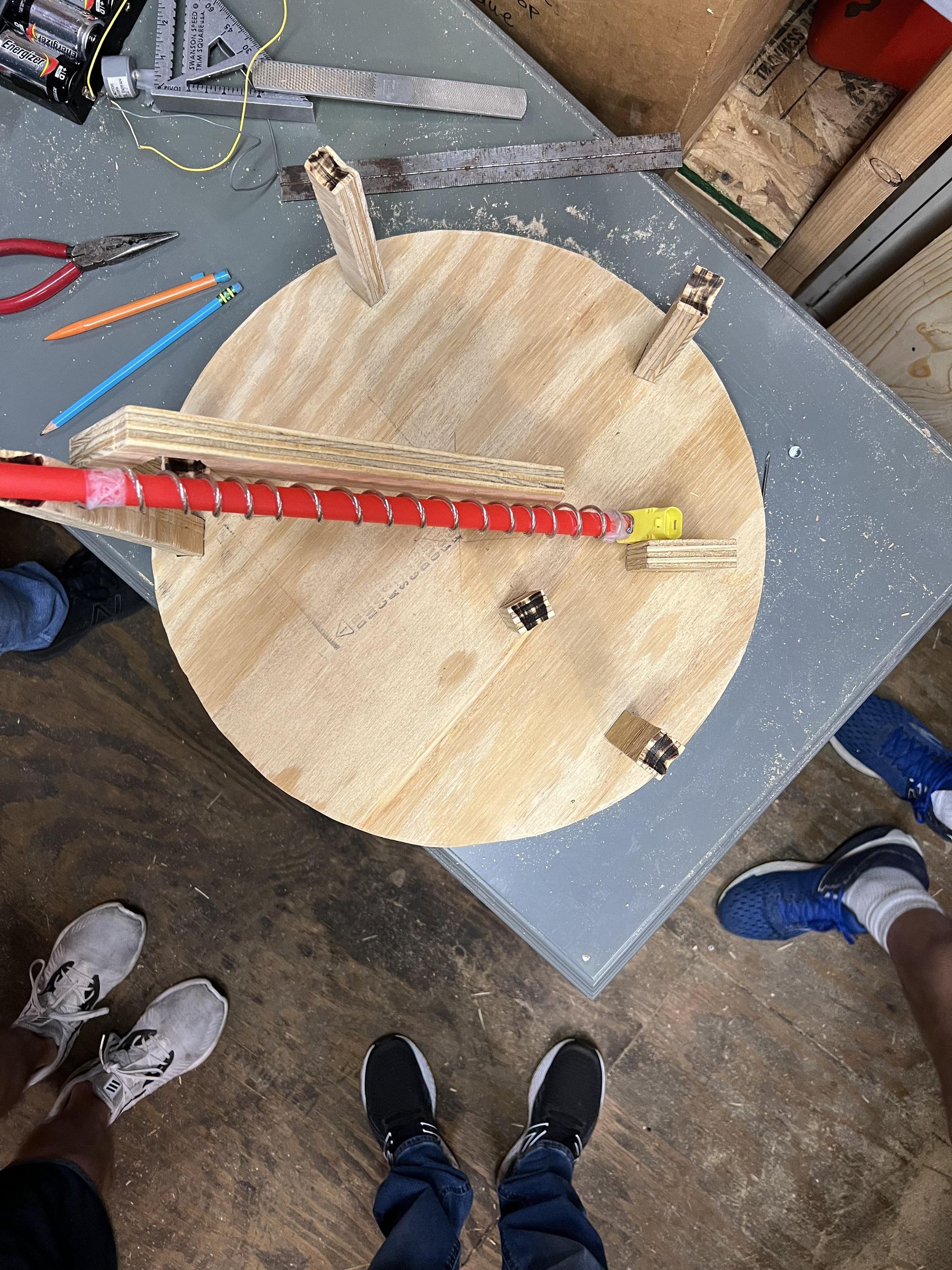

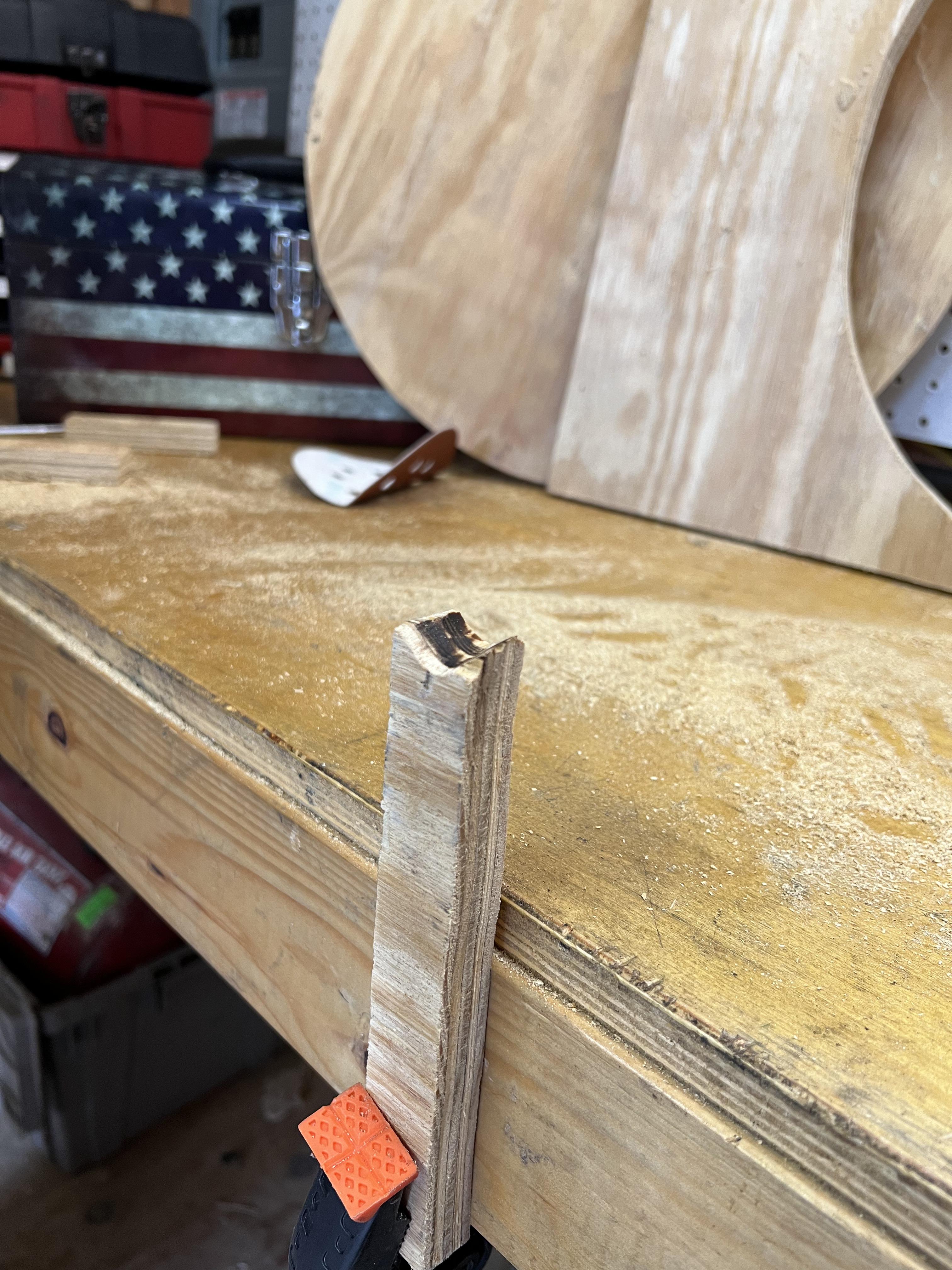

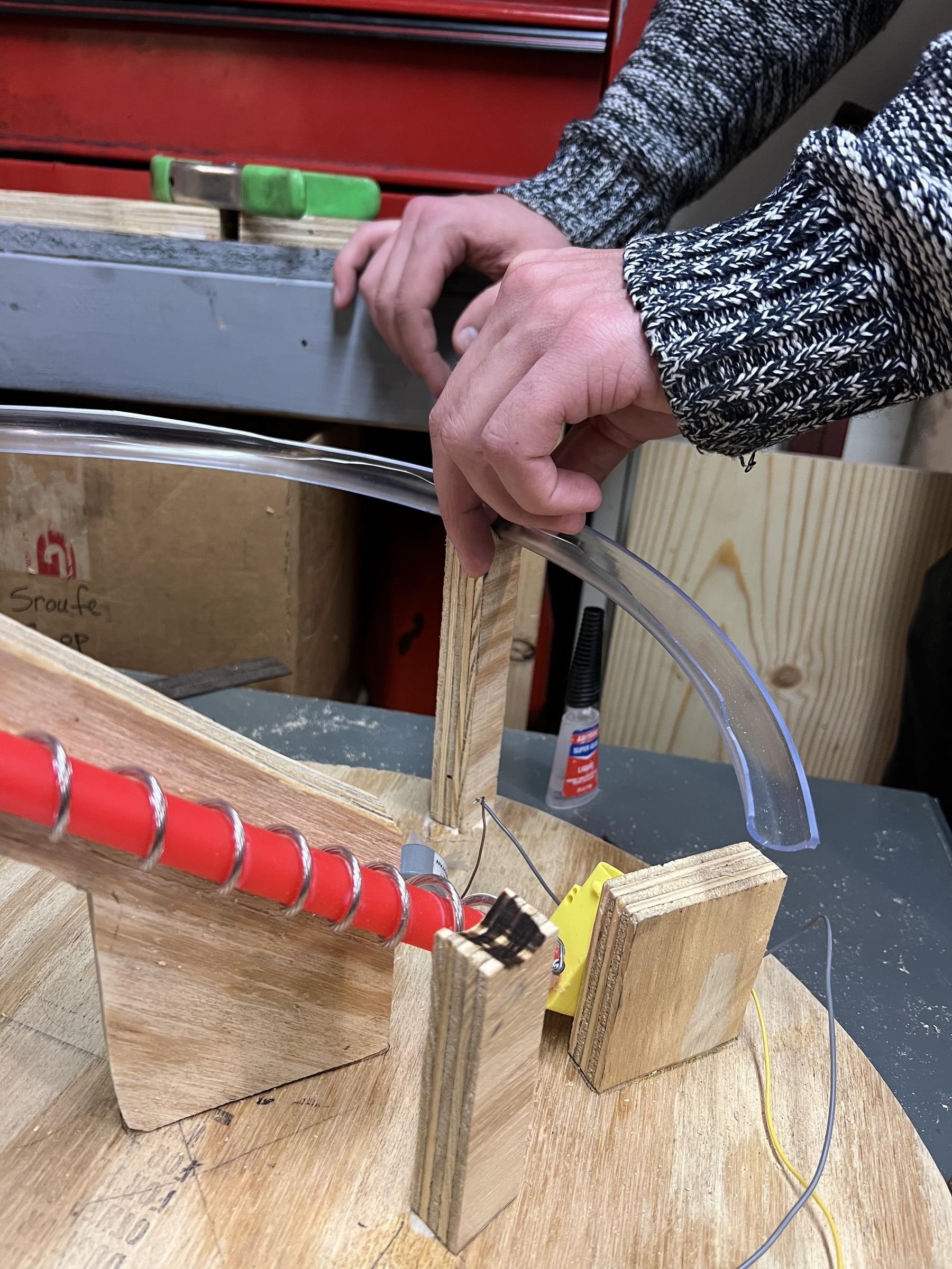

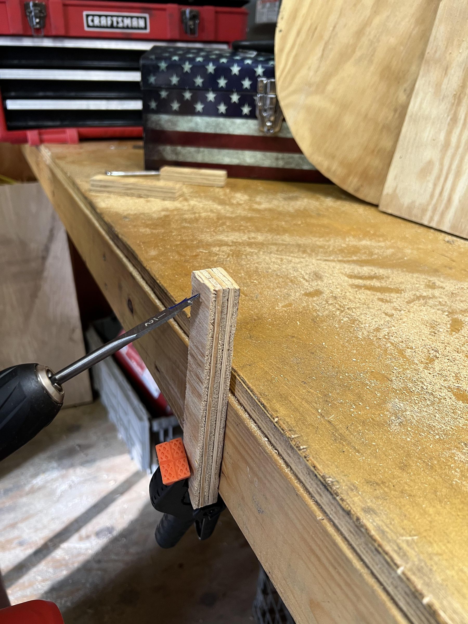

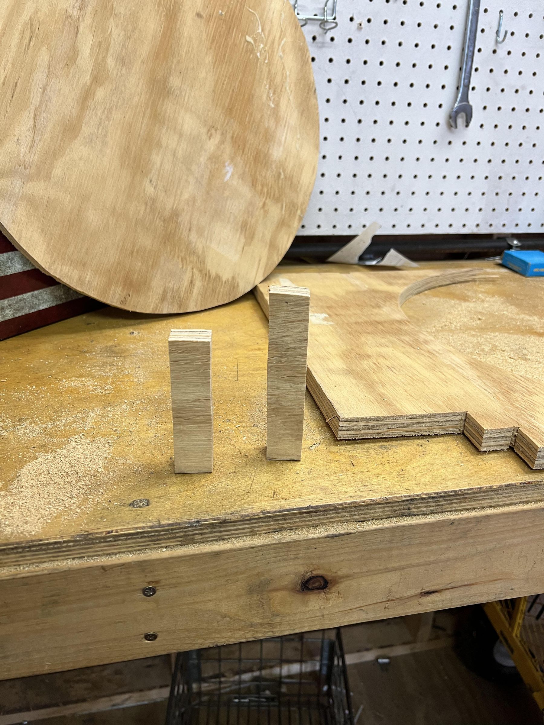

- Cut out track supports from the remaining wood. There should be at least four track supports in total. Each piece should be a different height ranging from 10" to 4". All supports must have a U shaped groove in the top in order for the track to fit. To do this, sand down a U-part into the support piece at an angle until the track section can be glued on at an angle of 5 degrees.
- Use Wood glue to glue the support pieces in place. The farther the distance between the pieces, the greater the difference in height for the support pieces.

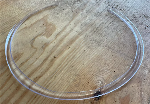

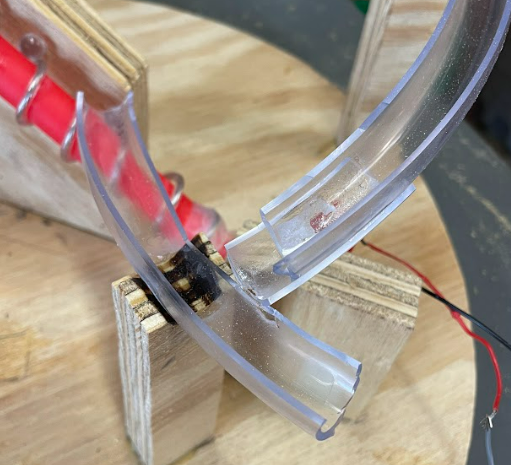

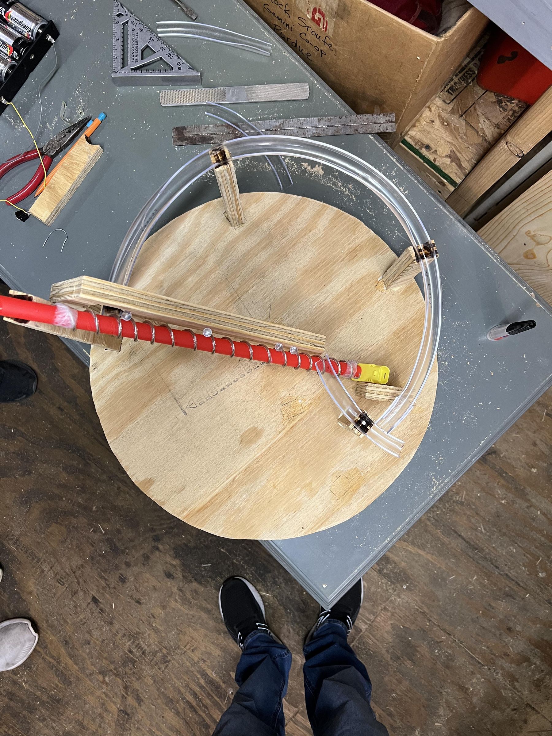

- Take the plastic tubing and cut it in half lengthwise. Cut one of these two pieces down to the desired length so that the tube can be placed on the first three track supports in such a way that there are no creases that will hinder the marbles movement.
- If the track piece needs to make any turns that are too sharp for it to properly transfer the marble to the bottom of the Archimedes screw, cut out a smaller piece of track section and use it to intercept the marble and turn it sharply.
- Glue the track sections onto the track support pieces.
- Test to see if the marble properly rolls from the top of the Archimedes screw to the bottom. If it does not, remove a track support as needed, adjust and glue it in the new position, repeat this until the marbles can consistently cycle through the system.
