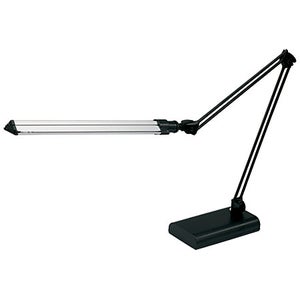

Step 1: Inspiration and Idea Sketch
This is my first idea sketch of the lamp and some photo's that give me inspiration on what my lamp should look like.

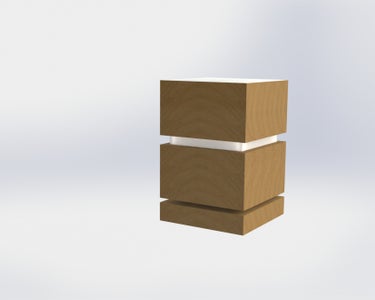

Step 3: 3D Models
The lamp

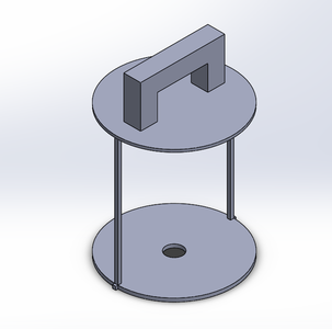

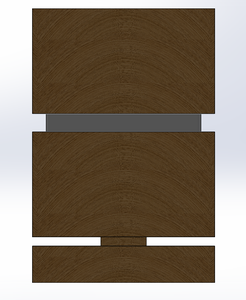

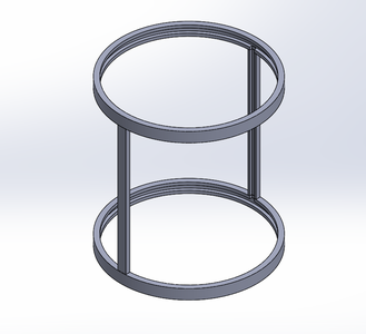

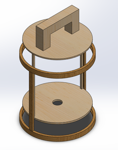

The lamp i wanted to make is like a cube, consisting out of wood and light defusing plastic. The light bulb is placed in the center of the lamp in a kind of "lift", but I'm going to talk about that later on. The light bulb is by default of, when its not used as a desk lamp. The light will be provided by a led strip, that is attached to pieces of cable cover, which are glued to the defusing plastic. The light will be switched from the LED strips to the light bulb, when a pressure sensor feels that the light bulb is being lifted up (so it could be used as a desk lamp.
The lift
This part is used for the removal of the light bulb out of the housing. On this part will be the light bulb for the desk lamp and an extendable arm, so that the lamp could be put in position.

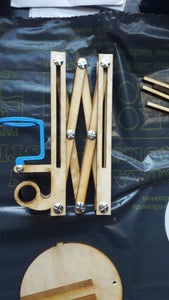

I firstly put together the extendable arm with both 6 mm bolts and nuts. You can use the 40 mm long ones everywhere, put you can see where the 30 mm ones look better. You can see the end result in the 2nd and 3rd pictures. I used the rings between the beginning and end parts, so i could space them apart. I also glued the rings on the inside of the finger-hole, so that it formed a solid tube. Then handles can also be glued together with wood glue.
To connect the wood and acrylic circles to the arm you need to use the hand drill with a 2 mm bit and both of the glues. You first need to drill holes where the arm needs to be connected to the arms and where the spacers need to go. You also need two holes where the handles connect with the acrylic plate. When you have these hole you first put some glue down to hold the parts in place and then you can begin to hit the small nails from the painting hanger set in place.
After you let the whole thing dry you have a solid structure, which you could easily lift from the ground.

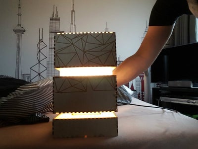

Now I screwed on the socket and Lamp cap to the holder and my lamp was almost finished. I only needed to glue the wood panels, that I left open in place. I decided to glue the top housing plate in and press the bottom part in, because this way I could still get to the wire and check on it if something didn't work.
And now I had a finished lamp that sits proudly on top of my desk.
