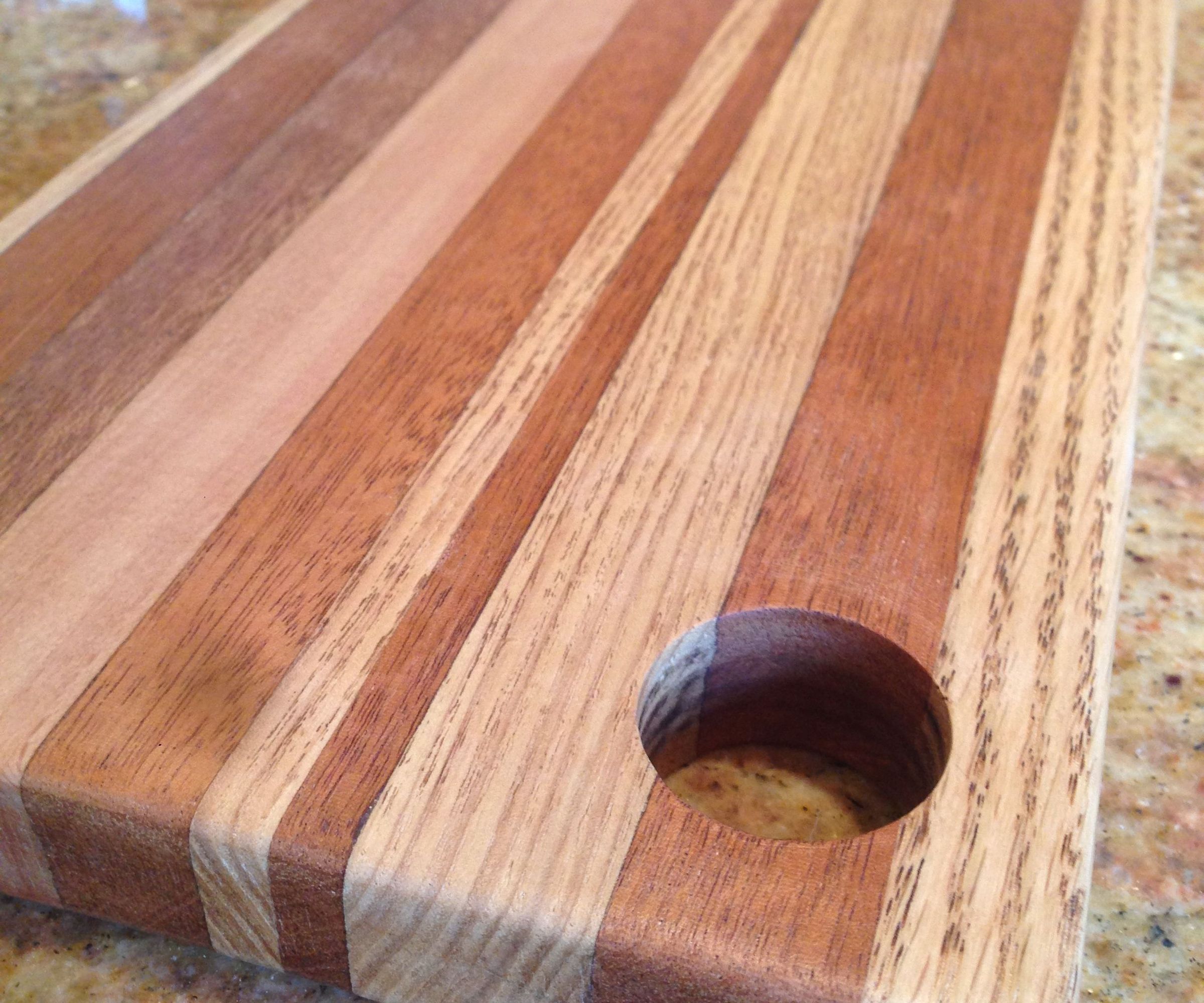

For the chopping board (not pictured) i laminated some different woods together before planing and finishing; instructable to come...
