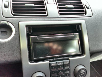

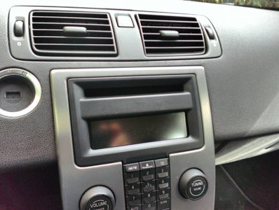

After some genius research, i found such an area in the middle of my radio/CD unit.

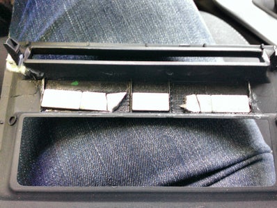

Luckaly this plastic front came off with the gentliest of pulls, and to my surprise, the backside seemed to be made for the magnets i had in mind.
So i ordered 5 Neobdymium magnets with an extremely high holding force (13 kg per magent, i used 5 of them).
Simply glued them with a cyano acrylate glue on it, during that action i managed to brake a few of those magnets; the holding force is so strong that they almost flew-thru-air to a metal plate nearby, cracking them on landing on the plate.
So after some good swearing, i puzzled the magnets and bits in place, glued them up, done.
In theory the magnets should hold 5*13kg = 65 kg.

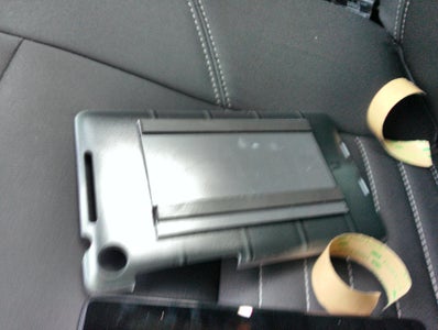

Step 2: Metal Plate on My New Bought Tablet? I Think Not.
So i found this great excuse to finally buy me a tablet, and the first thing i need to do is glue a metal plate on the back to stick to the magnets.
I think not.

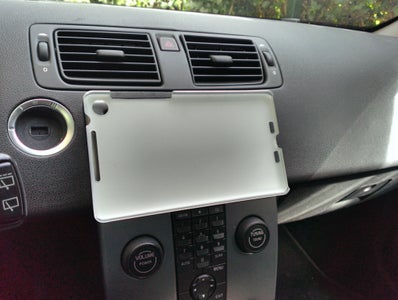

After again some genius searching on the web, came across something called a hard shell, clamshell, hard case. its a thin plastic shape that fits around your device to protect it a bit, should it fall, from scratches.
This little 5 dollar thing might be just perfect, and , since it costs only 5 usd, i don't mind taping a metal plate on it.
Estimated roughly what the size of such a metal plate should be, cut it and used double sided tape to stick it on the hard case.
The foam tape version i used was 1 mm thick, its a 3M VHB type, found the 1 mm thickness was better than very thin, as it had to fill up a small cavity in the plastic front.
I also taped thinner strips of a foam tape i had on the other side of the metal plate, the 2 lines visible on the first pic, those touch the plastic front, as a buffer to solve minor resonance of the tablet on the front, plus the strips touch the CD opening and hold the tablet horizontal.

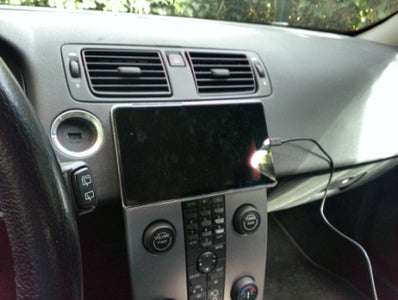

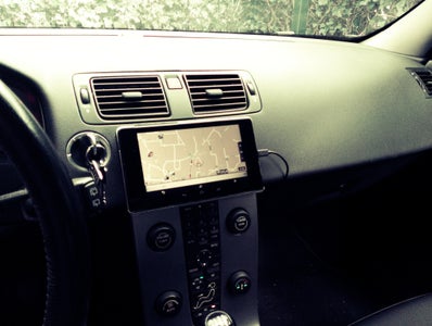

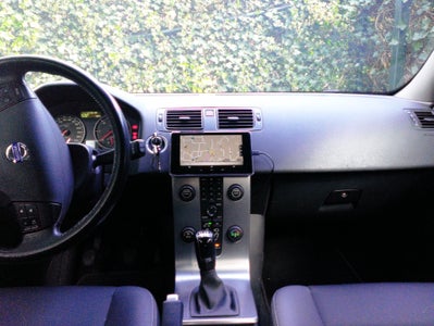

Step 3: Done, Damn This Look Good
Yes yes, i have to say so myself, the tablet fits perfectly over my radio, oops, where is my radio display?
i have ordered a new USB charger cable with a 90 degree bended plug, so the cable goes directly downwards, on these pics it still uses the original cable going to the right.

So i studied a bit , yes genius research, magnets. Seems the holding force reduces by 50 % for each 1 mm you move it further away from the metal palte.
In my case, the distance is indeed 1mm, the thickness of the plastic front.
So the holding force lowered from 65 to 33 kg, roughly, i'm not that a genius that ic an just simply devide such an akward nr 65 into 2 even bits.
Ok, reading again, seems holding force doubles if you stick the magnet in between 2 plates of metal, or even tripples. So, i simply did cut another strip of metal, size 9 mm * 100 mm, covering the 5 magnets perfectly on the back of the plastic front, and yes indeed, the holding force is really much higher.
