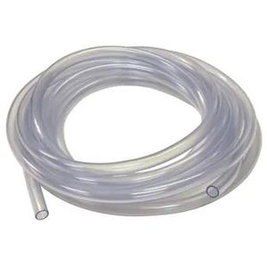

12 in length of 3/8 in ID (Inner Diameter) vinyl tubing.
https://www.lowes.com/pd/EZ-FLO-3-8-in-Inner-Diame...
36 in length of 1/4 in ID vinyl tubing.
https://www.lowes.com/pd/EZ-FLO-1-4-in-Inner-Diame...

Next you'll need to connect the 12" length of 3/8" ID tubing to the barb on the 3D printed fitting and then slide the Cerberus tank into the center hole, with the smaller diameter hole flush with the flat bottom of the tank, so only the threads protrude. Then screw the whole unit into the GeekVape Aegis mod.
Step 3: Insert 1/4" Tube
Insert the length of 1/4" tubing into the mouthpiece and cut to necessary length. That's it! construction is complete.
