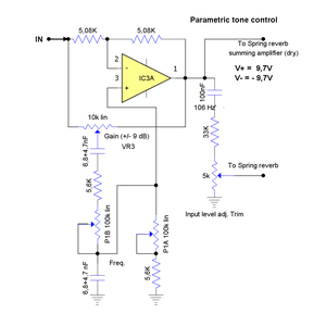

Step 4: Parametric Tone Control
The parametric tone control consists of a frequency pot and a level pot. The frequency can be set from 200 Hz to 3 kHz, and the level can be set from -9 dB to +9dB. Curtesy of  Rod Elliot (Elliot Sound Products).
