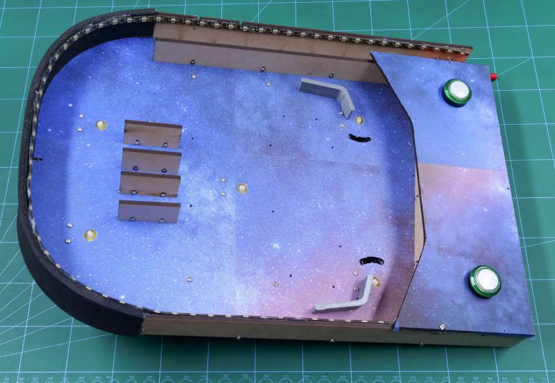

Step 4: Attaching the Boundary Walls
Take both the left boundary wall and the right boundary wall and attach it to the base plate using M3 nuts and bolts(as shown in image 1).
Once done, take the front wall and attach it to the base plate and left boundary wall(as shown in image 2). We will not be attaching the front wall to the right boundary as the space left here is to make the Launchpad. Launchpad is nothing but the corridor from where we will be launching or shooting our ball into the playfield.
Step 5: Assembling the Launchpad and the Drain
Now, let’s make the launchpad and the drain. Launchpad as you already know is the place from where we launch the ball into the playfield. The drain is the place which ends the game i.e. once the ball reaches the drain, it can no longer return to the playfield in that chance. Also, the ball in the drain rolls down and ends up in the launchpad. Now, that we know what is what, let’s start their assembly.
Take the extra wall and attach it to the front wall and the base plate(as shown in the above image 1).
Now, take the drain wall and attach it to the extra wall and the left boundary. You may notice that the drain wall is a bit slant which makes it easy for the ball to roll down(as shown in the above image 2).
Once done, attach the launch wall parallelly to the right boundary wall on the base plate. Make sure you leave some space between the extra wall and the launch wall. This space will act as the gate between the drain and the launchpad(as shown in the above image 3).

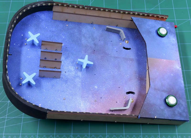

Step 9: Adding the Motors
You may notice that the playfield in pinball is never empty. There are tons of elements that are present on the playfield to make the game interesting. Out of which one is the flipper and the other is bumper.
Bumpers are the one that rotates continuously pushing the ball away in any random direction. Thus, attach 3 DC motors near the top boundary using M3 nuts of 20mm length and bolts.
Now, its time to add the flipper motors. Flipper motors will be attached towards the draining end. Will discuss what flippers are in the next step. Till then remember, they are the ones who can save you.

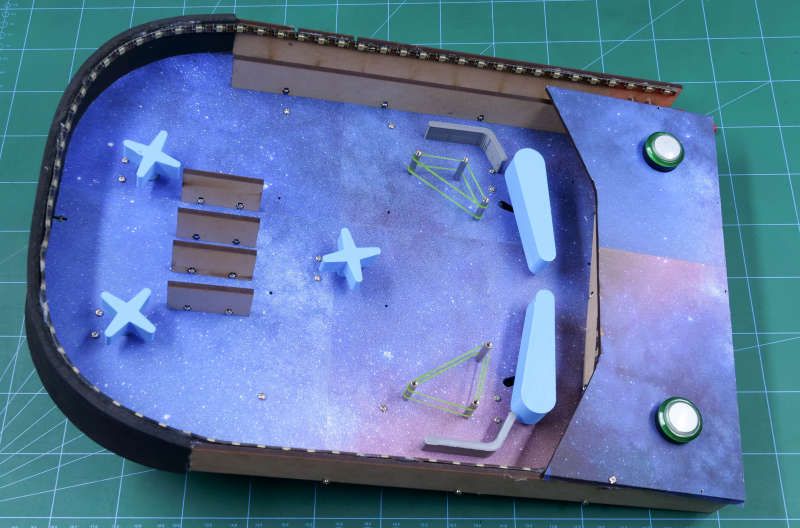

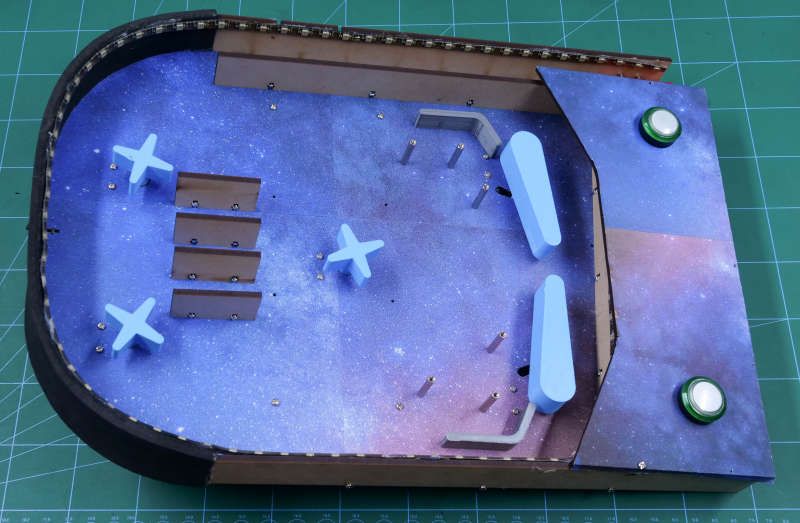

Step 15: Time to Add the 3D Printed Parts
Lets first add the side lane walls, these will direct your ball to the flipper if the ball enters the lane.
As we already know the use of the bumper. Fix them on the free shafts of the DC motors.
Time to add the flippers, fix the flippers on the shaft of the DC motor. Also, make sure that the flippers fit nicely in the curves given.
With this, your entire assembly of the pinball is complete.

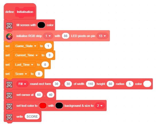

Step 17: Time to Code
We are going to write code in PitoBlox, a Scratch 3.0 based programming software. Upload the following script to evive.
