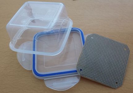

Step 1: Hardware & Software
- The epoxy board is cut to fit right into the box top.
