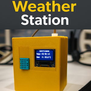

Introduction: Tabletop Weather Station Using Arduino, DHT11 Sensor & OLED Display
Imagine having a miniature weather station right on your desk - compact, modern, and smart. With this Arduino-based Tabletop Weather Station, you can monitor real-time temperature and humidity using a DHT 11 sensor and display the data on a 0.96-inch OLED screen.
This project is perfect for students, makers, and hobbyists who want to learn about IoT fundamentals, sensor integration, and data visualization.

Once uploaded, open the Serial Monitor (115200 baud) to view live readings.
Step 4: View Live Data
The OLED screen will now display your room's:
DHT11 DATA
Temp: 28 C
Hum : 62 %
Readings update every two seconds, allowing you to observe temperature and humidity changes in real-time.
