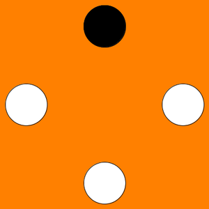

Step 5: Processing Sketch: Receiver
The code below is a simple demo, able to receive the key info sent by the Arduino.
import processing.serial.*;
Serial myPort;
char key= 'N'; //default = no key
void setup(){
size(400, 400);
//hardcoded port selection. Mine is the second port, you'll have to check which is your Arduino Serial
println("ports: ");
println(Serial.list());
myPort = new Serial(this, Serial.list()[1], 9600);
void draw(){
background(255, 128, 0);
fill(255);
//four white circles
ellipse(200, 50, 80, 80);
ellipse(200, 350, 80, 80);
ellipse(50, 200, 80, 80);
ellipse(350, 200, 80, 80);
if(myPort.available() > 0){
key = myPort.readChar();
println(key);
fill(0);
switch(key) {
//if one of the keys : black circle
case 'T':
break;
case 'B':
break;
case 'L':
break;
case 'R':
break;
//if N: do nothing
case 'N':
break;
key= 'N';
