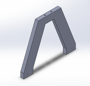

Step 5: 3D Print Supports
3D print two of “Overhang V3.STL”
Step 6: Bolt the Supports to the Base Frame
These 3D printed supports should be bolted to the frame using the corner brackets inserted in step 4 using M4x22 button head cap screws. Make sure both the supports and the heads of the bolts are on the inside of the corner brackets. Put M4 nuts on the other side and tighten. The M4x22 screws we used came with the stepper motors.
