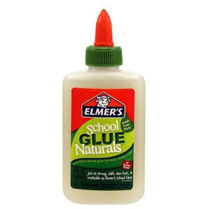

Step 6: Optional Biodegradable Fixative
Store-bought spray fixatives like those pictured above will work for this ink, but they have the downsides of being both expensive and relatively environmentally unfriendly. They're generally sold in aluminum aerosol cans and contain synthetic polymers with chemical solvents of varying noxiousness and flammability. They aren't necessarily terrible, and they do generally perform really well. But I find that the recipe here works just as well, smells better, costs less, is biodegradable and is, depending on which school glue you choose, either biodegradable, or biodegradable and compostable like Elmer's natural school glue. (My personal bottle looks like it both participated in, and badly lost, a paintball gun fight. Some possessions must unfortunately become casualties of the artistic process. Please enjoy this stock photo instead.)
If at all possible, use a sprayer that produces an ultrafine mist. The smaller the mist particles, the better the coverage, and the less likely you are to damage parts of your artwork by waterlogging the paper. Reused bottles from hair products or perfumes are often good enough. We're using alcohol instead of water because it evaporates much faster and is therefore a lot harder to damage your paper with.
Recipe:
4 oz (1/2 cup) Isopropyl alcohol. Any drugstore percentage is fine.
1 tbsp school glue.
Measure these out into your misting bottle and shake it well until combined. Like most sprays, several light layers of this are better than one thick layer.
