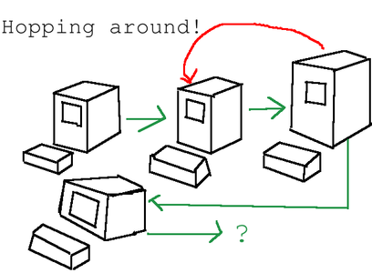

Let's log into the first system.
[eddie@oedt01 ~]$ ssh robopet
Linux robopet 2.6.12-9-386 #1 Mon Oct 10 13:14:36 BST 2005 i586 GNU/Linux
The programs included with the Ubuntu system are free software;
the exact distribution terms for each program are described in the
individual files in /usr/share/doc/*/copyright.
Ubuntu comes with ABSOLUTELY NO WARRANTY, to the extent permitted by
applicable law.
You have new mail.
Last login: Wed May 23 14:42:04 2012 from oedt01.homelinux.com
So far so good, let's log into that second system.
eddie@robopet:~$ ssh oesrvr1
eddie@oesrvr1's password:
Linux oesrvr1 2.6.32-41-generic-pae #89-Ubuntu SMP Fri Apr 27 23:59:24 UTC 2012 i686 GNU/Linux
Ubuntu 10.04.4 LTS
Welcome to Ubuntu!
* Documentation:  https://help.ubuntu.com/
0 packages can be updated.
0 updates are security updates.
You have new mail.
Last login: Wed May 23 14:42:20 2012 from robopet
Now we are logged into a second system which could be next door or half way around the world. And we did not even have to purchase a plane ticket. So now let's find out about another system. We will use Google for this test. What we about to do is known as penetration testing at the baby step level. We are going to use a program known as nmap to help us. So that nmap is not used lightly, generally administrative or root rights are required. So we use sudo to preface our command.

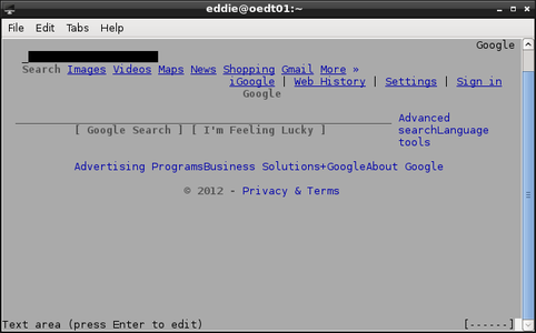

The last time I did this the operating system was not even guessed and only two ports (80 and 443) were shown. We will look at ports 80 and 443. We can use a program called links2 to access the websites from the command line as if using Firefox or the like.
eddie@oesrvr1:~$ links2 www.google.com:80
                                                                         Google
   _________________________________________
   Search Images
   iGoogle | Web    +------------ Exit Links -------------+
                    |  Do you really want to exit Links?  |
  _______________   |                                     |   dvanced
           [ Goog   |           [ Yes ]  [ No ]           |   earchLanguage
                    +-------------------------------------+   ools
           Advertising ProgramsBusiness Solutions+GoogleAbout Google
                           (c) 2012 - Privacy & Terms
Yes, port 80 works.

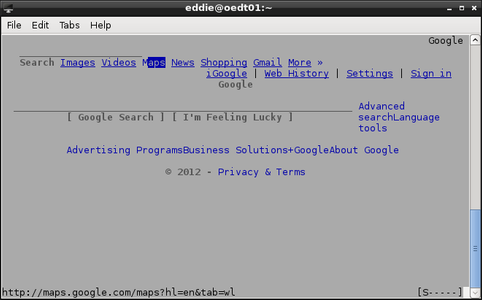

eddie@oesrvr1:~$ links2 www.google.com:443
                    |           [ Yes ]  [ No ]           |
We have to use a special prefix for port 443 to work.
eddie@oesrvr1:~$ links2 https://www.google.com:443
                                                                         Google
   Search Images

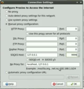

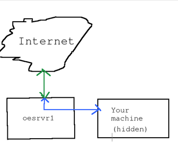

Now lets apply the knowledge. We will set up a proxy computer. that s a computer to act as us. Say you need to go to a website, but you do not want to use your local ipaddress for security reasons. For example: say advertising sites that want to know who is connecting to them. A small amount of anonymity if you can use a proxy  First lets see what your up address is: (whatismyip.com will get you that informaton).
Let's log into one of the remote machines with a special command (oesrvr1 is actually 192.168.1.31)
$ ssh -D localhost:9999 oesrvr1
Login and just minimize the window for now as the magic is done.
For our purposes will will use the local server to do the trick. http://oesrvr1/getmyip.php is our url for locating the users ipaddress. (IT IS NOT ON THE INTERNET) You will need to start your firefox web browser to see this.
Doing that we see our ipaddress is  192.168.1.115
No let's go in and change the socks setting.  to 127.0.0.1 with a port of 9999 in your browser.
Now let us go and check the ip address again.
Lo and behold Your address is changed to 192.168.1.31.
So anyone wanting to know where you are browsing from.  thinks you are sufing from oesrvr1.  In the real world you would want to use a real internet address outside of your local network to see a real change in the ipaddresss. There are several free shell sites that will let you could use as a proxy..
