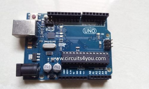

1. Arduino Board

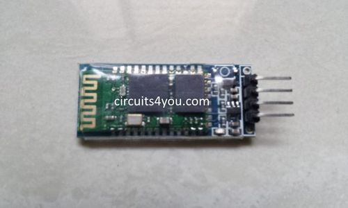

2. Bluetooth Module HC-06

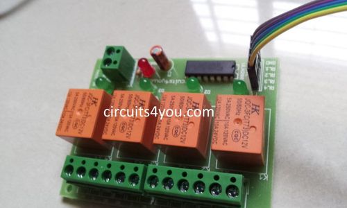

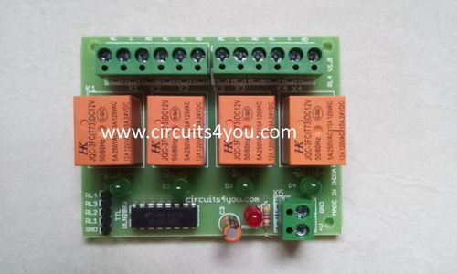

3. Relay Board

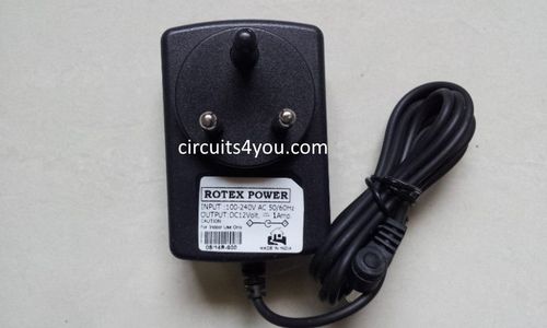

4. +12V Power Supply

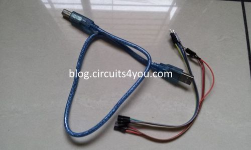

5. Connecting Wires

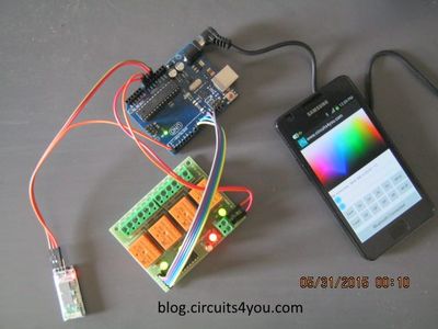

Step 2: Connect Relay Module and Bluetooth With Arduino
  1. Connect relay module ground to Arduino GND
  2. Connect RL1 to RL4 to Arduino Pins 9,10,11,12
  3. Connect Bluetooth module GND to Arduino GND2.
  4. Connect Bluetooth module VCC to +5V of arduino
  5. Connect Txt of Bluetooth module to Rxd (0) pin of arduino
Step 3: Connect Power to Relay Board Using M-M Connecting Wires
  1. Connect GND of relay board to Arduino Ground
  2. Vin/+12V of Relay board to Arduino Vin

  6. Download Code in Arduino Board. Note: while Downloading Arduino Code Disconnect the Bluetooth module

Step 5: Testing
  1. Turn on all setup
  2. Turn on Bluetooth on your phone and pair it with HC-06 (Pin 1234 or 0000)
  3. After successful pairing start the application
  4. You have done it…..
