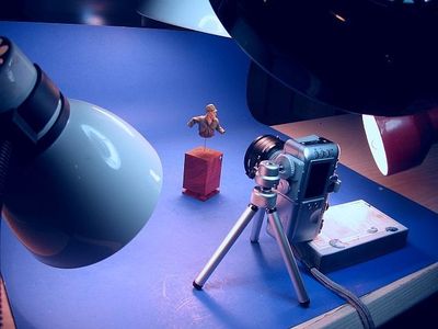

Here is the "behind the scene" image - a right shambles - of my set up. As you can see, no frills. I had not placed the diffusing paper over the lights. There should be a sheet over the two side lights. There is also a light directly above the subject. It is important to work the light positioning so that one light eliminates the shadows created by another light. It is a bit of work but when you get the positioning, all the images will turn out much better.

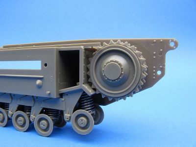

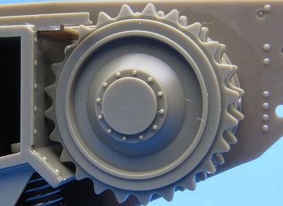

For armour, here is the difference: photo of a Churchill sprocket using regular camera lens and same using aftermarket zoom (or 'close-up' lens fitment):
